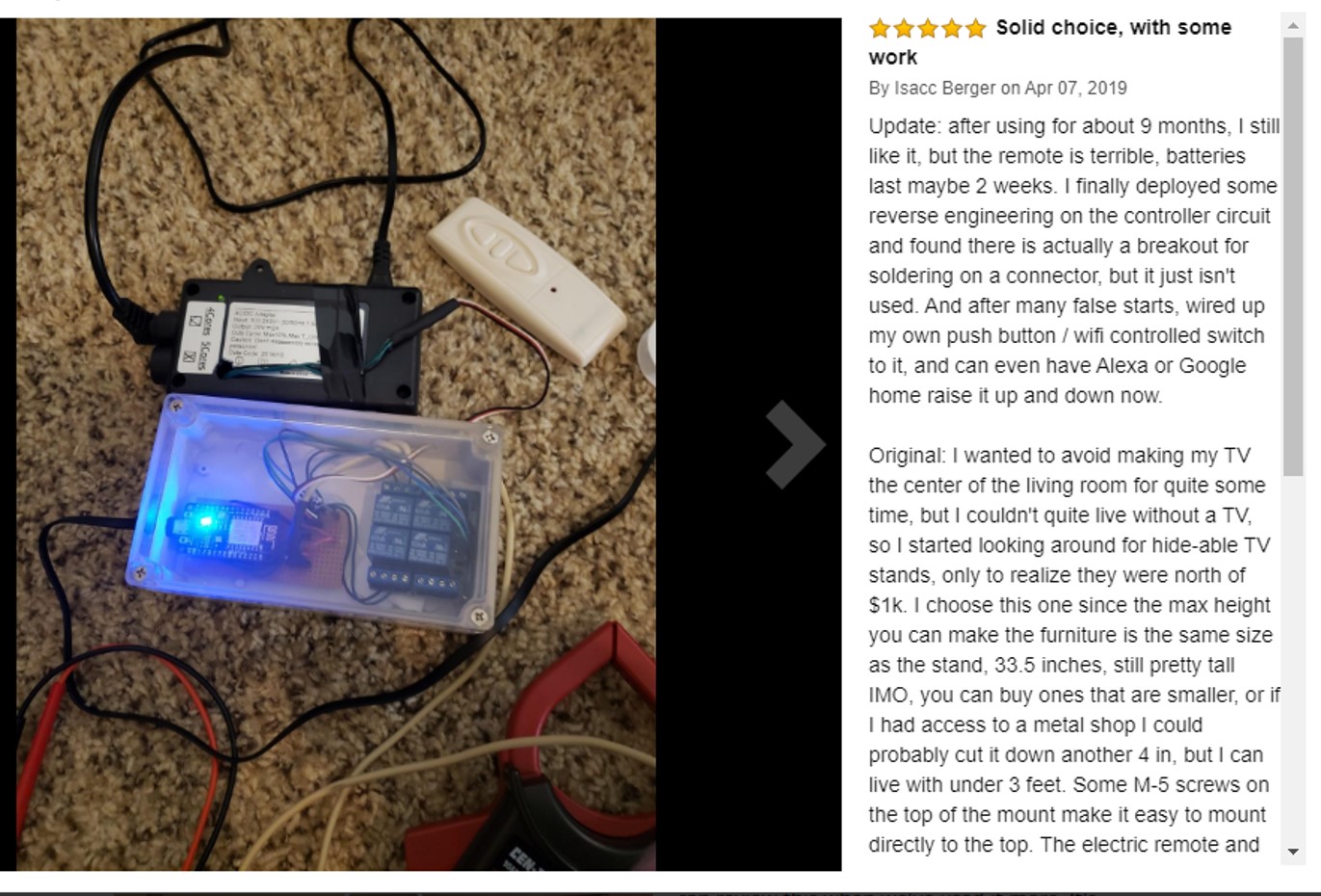

This is a screen shot of the gentleman’s post on Amazon. I noticed his is using a 4-channel relay board, and a wifi module separately. The wifi module I used was a 2-channel relay and wifi built into one.

From the amazon customer pictures, it looks to me like the lift is being driven by simulating the PB in the lift control using an ESP32 controller. Like # 3 below.
Update: after looking at other offers of the lift on amazon it looks like the control panel is separate from the controller. Therefore I think this hack I think the control panel was replaced with an arduino+relay module to simulate the panel.

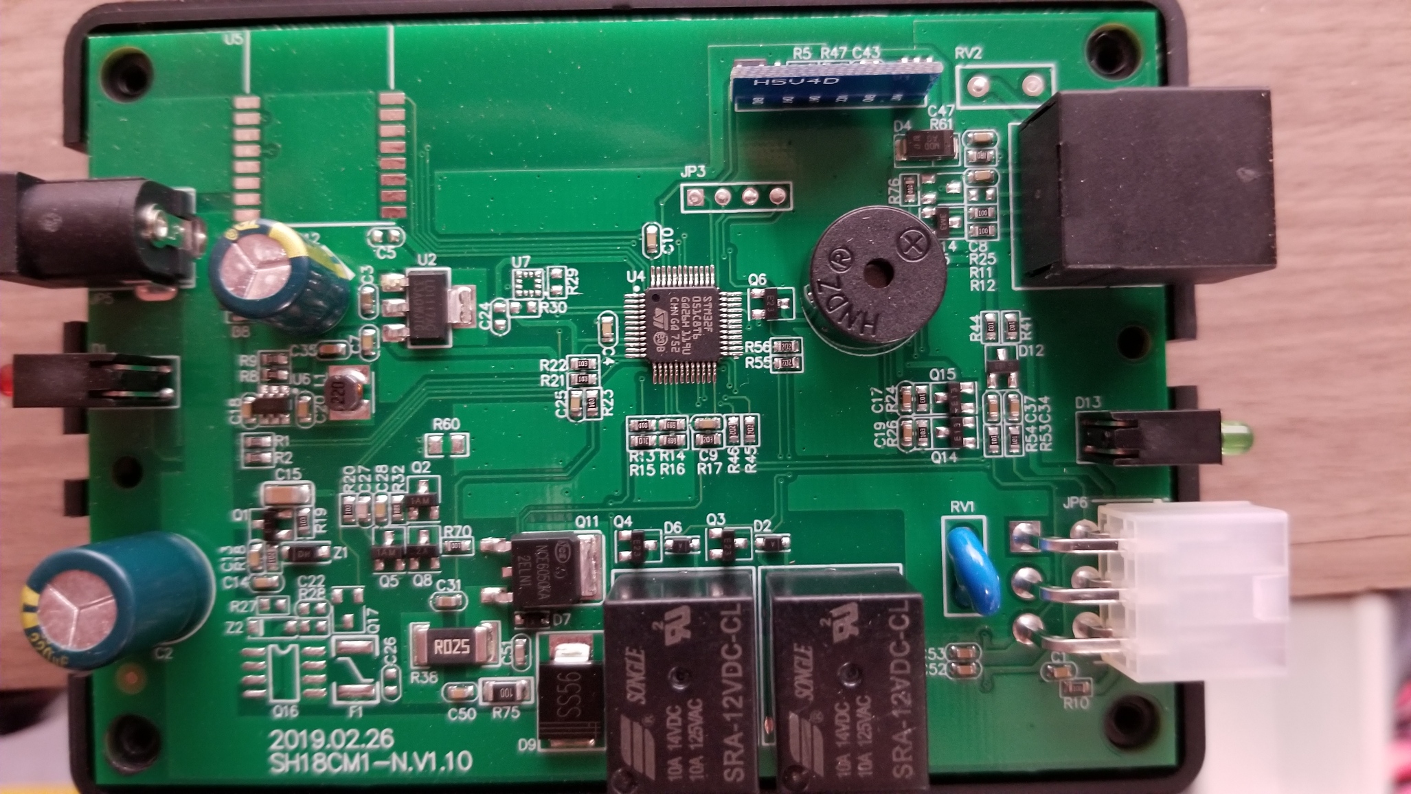

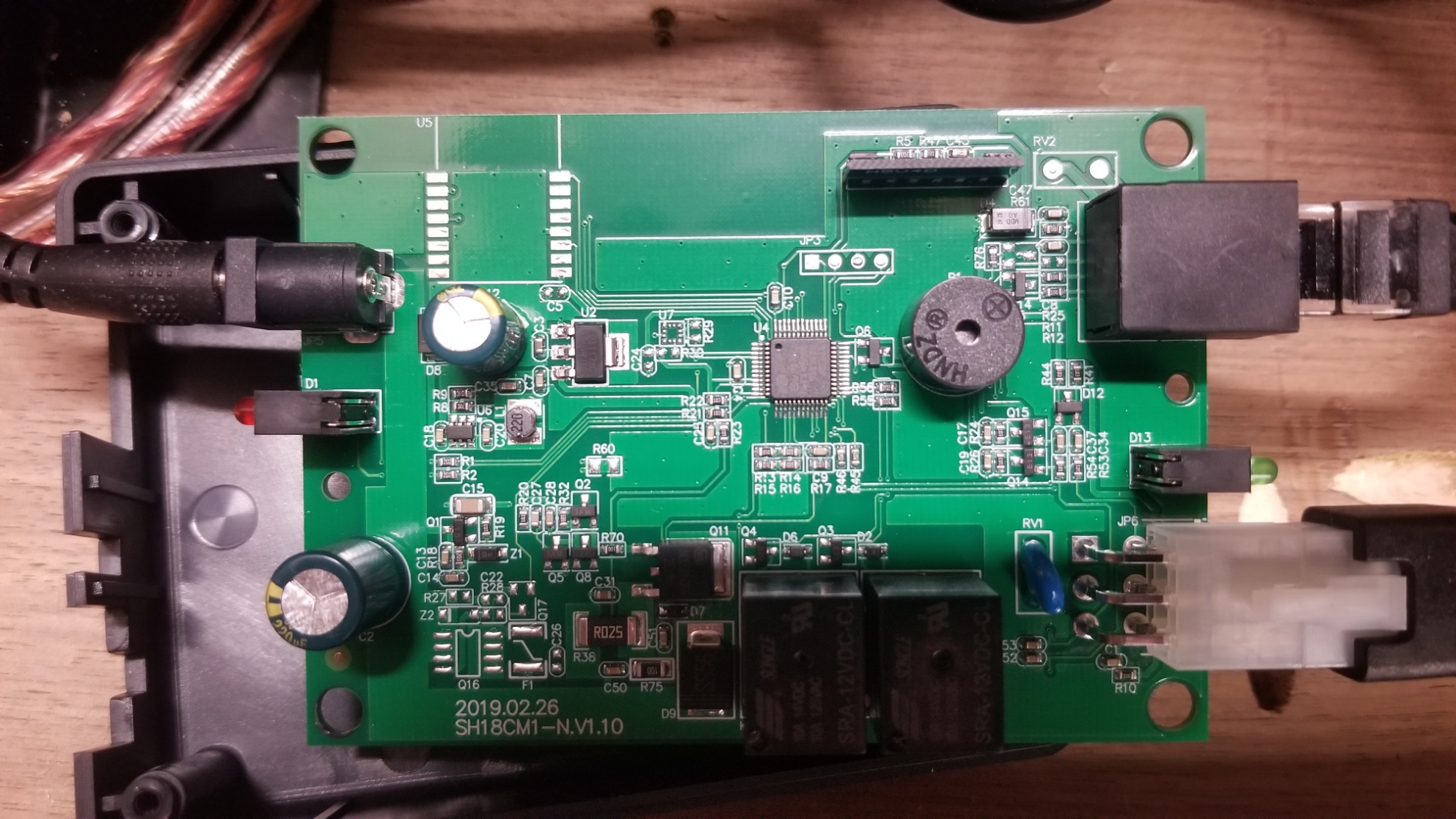

Thank you for the info. I think I’ll try and see what’s behind door number 1. I think I can find what pins control the up and down. The unit (as with most things from China these days) did not come with any user manual. The device setup is pretty straight forward. All of the wiring goes into one control box. There is a control panel that is attached to the main box via CAT5 cable. Here’s a picture of the control board.
The left side is just the power supply. The right side top with the CAT5 goes to the control panel. The bottom right six pin connector goes to the lift. I haven’t tried to get into the lift yet as its pretty sealed up. The unit also came with a remote control, but I haven’t tried it yet. I’m assuming the receiver is on the control panel. The control panel has up and down buttons as well as four buttons that you can program for up or down. You set the desired height using the up and down arrows, then program one of the four numbered buttons to go to that set height.

Let’s take close-ups of these areas of both sides of the PCB.
  • The main processor showing its part #.
  • The CAT5 cable and its routing to the processor

Here’s the front of the control board:
Then the back:
Close up of the Cat 5 port. It looks like they’re only using four of the wires.

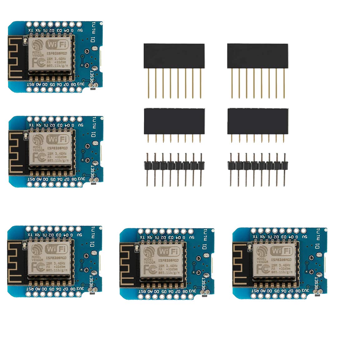

This just looks like a ESP8266?
