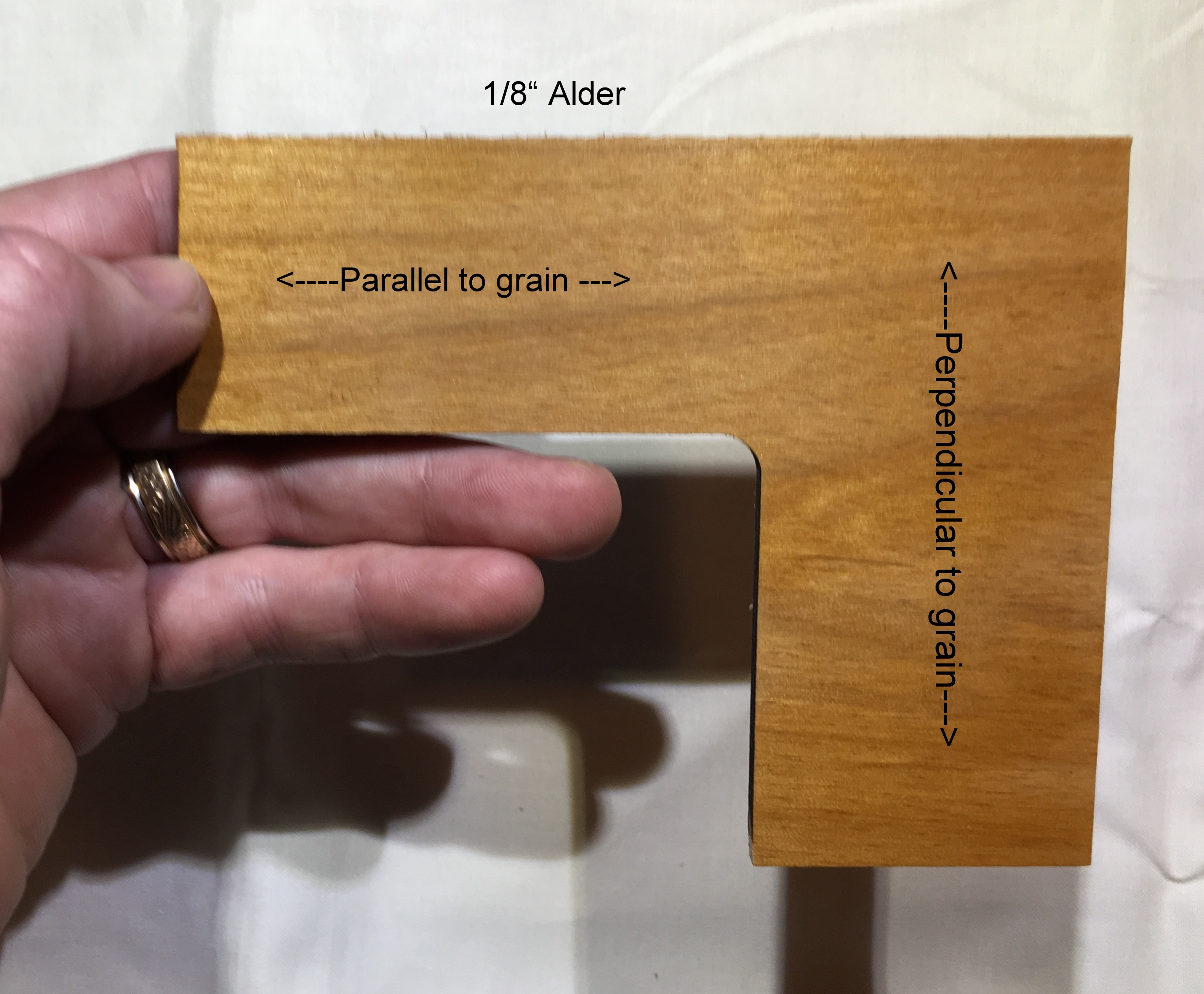

In this edition of #K40ShopTips let’s consider the impact of wood grain direction on your creations. In my experience there are two ways direction of the wood grain impacts projects created with wood, structural and visual.
The structural aspect is typically related to how much a piece of wood will bend when a load is applied, in that a piece of wood is stiffer parallel to the grain then perpendicular to the grain (see pics). This becomes more important as the wood becomes thinner and the pieces cut become narrower. In general, you usually like to have the long direction of you piece parallel to the grain for the best stability, but it will depend on your application. Plywood typically is less affected than solid wood and pieces >= ¼” thickness are also less affected.
