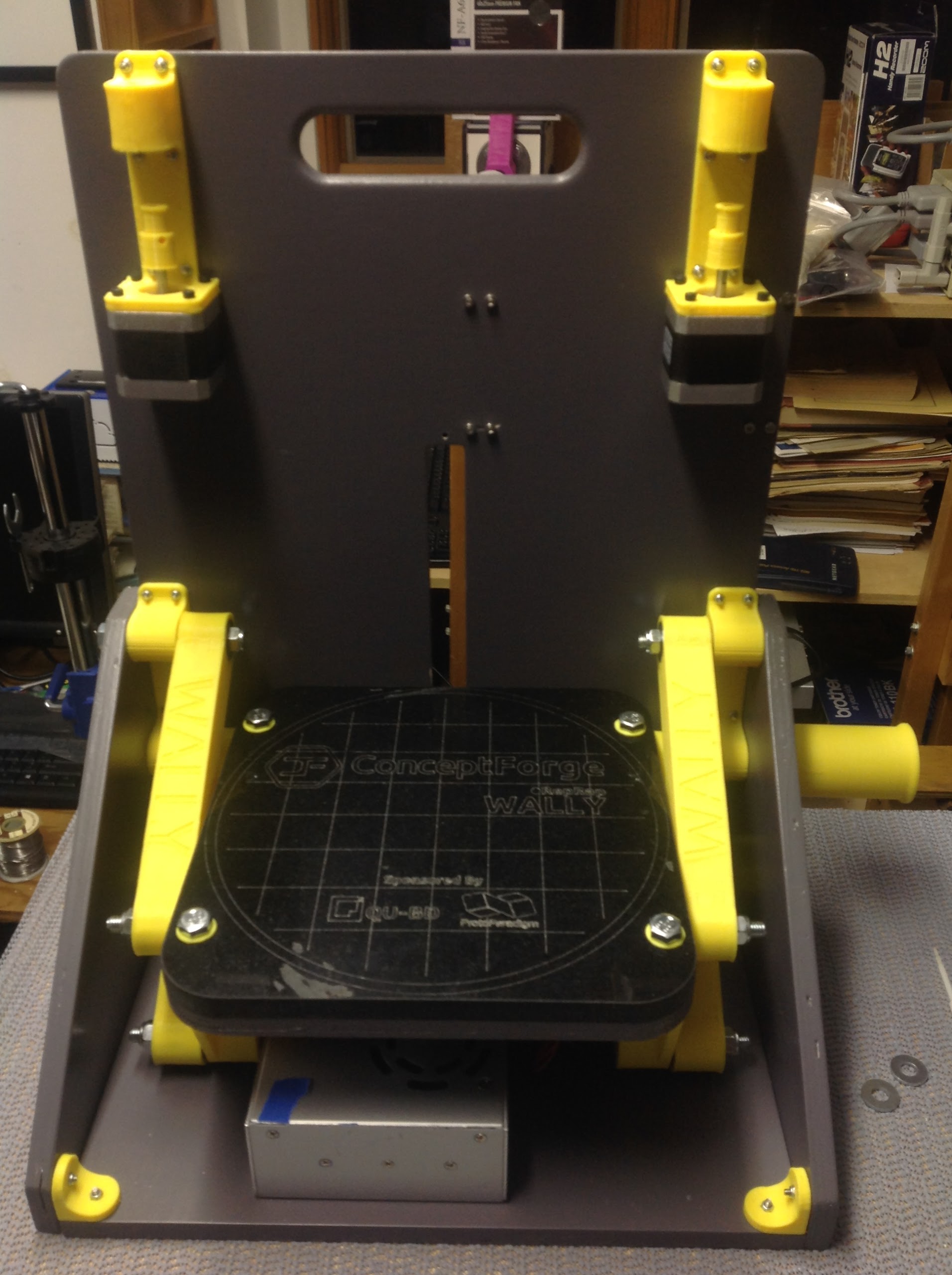

Wally bed is in and works going positive Z only..
Wally bed is in and works going positive Z only… Repetier thinks I should have end stops. Got to change that but have forgotten how.

You can disable all the endstops in the config.h file. Just set them all to false. How the hell do you home though? Or is this just for testing?

@Tim_Rastall homing is easy. Drop the bed for Z, pull arms out straight for XY (there are tabs that stop you when they are straight). Not that XYZ really apply in Wally’s Polar world.
