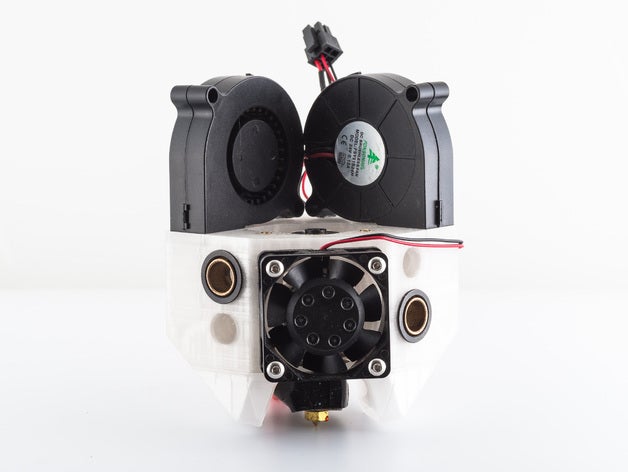

@Walter_Hsiao , Your work is always so good. Love the updated compact Eustathios carriage:
Thanks Eric! I still need to add it to github and send in a pull request. I’ll do that soon.

I like the fans placed on top !, would this thingifile also work on my single Hotend Herculien ? (but keeping my 650 mm bowden-tupe)
@Ben_Delarre For the hotend wiring, I originally installed it with a cable chain, separate from the bowden tube, and left it like that even though the flying extruder arm would be a perfect place to run the hotend wiring (too lazy to redo the wiring).
@Jo_Miller This carriage should fit on the Herculien (I think they use the same cross rod spacing and the 8 and 10mm self aligning bushings mount in the same holes). The nozzle is significantly higher though, so I don’t know if the bed will reach the nozzle on the Herculien without other changes. I don’t think it reaches with the normal Eustathios Spider v2 build.

@Walter_Hsiao I am so glad you also post STEP files, I was able to model a spacer that went under your duct for the E3D Volcano. It was a perfect fit.
@Bud_Hammerton Please share
Took me a bit to figure out how to make the pull request, but it is there now. It is just the spacer and nothing else. included multiple 3D model formats as well as the STL.
Just as an FYI, I did not use this myself, I actually combined it into one piece with the duct section and printed it as a single piece.
@Bud_Hammerton thanks, I love that people are using the github for archiving these mods and collaborations. I think it will help long term so all these great additions don’t get lost in the G+ streams.
Thanks Bud! Good to hear the step files were useful. I’ll have to try out the spacer, I was planning on making a volcano duct, but have never gotten around to it.
Spacer adds 11 mm depth per E3D’s specs. You can always scale in the Z axis of needed.

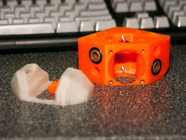

Made one. Had to order some magnets as I only had 10 mm round on hand.
Cool! Looks great, hope it works well for you. Thanks for sharing the picture
