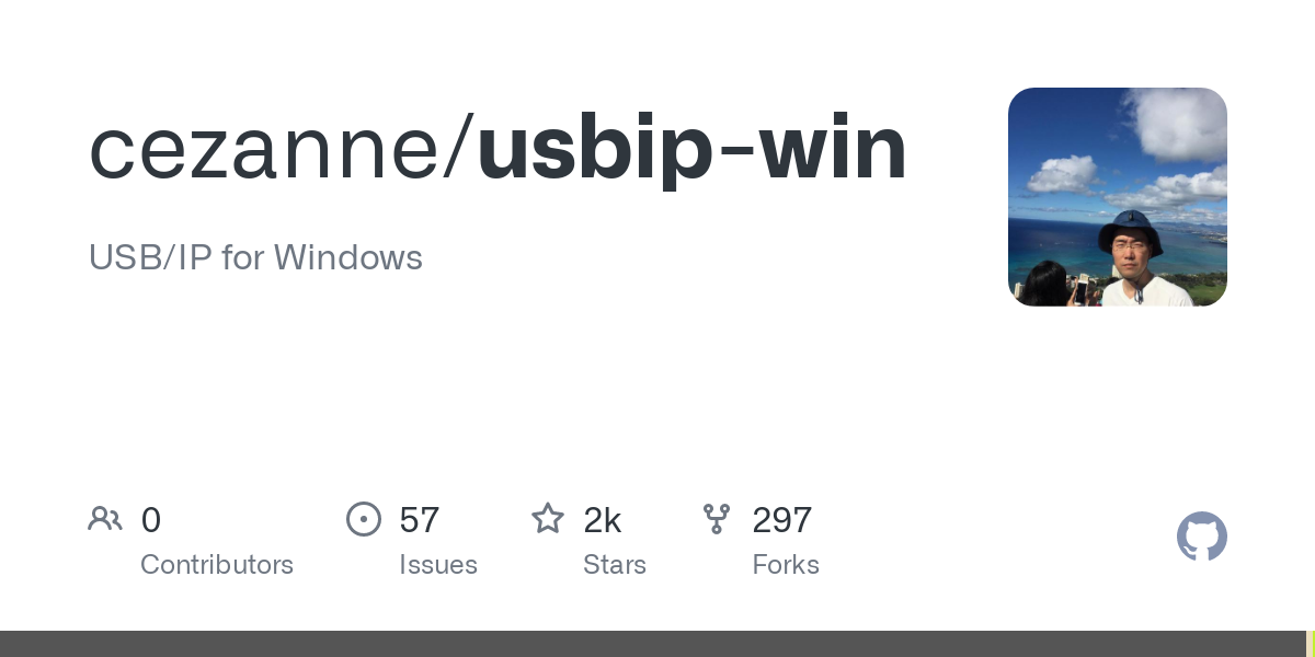

maybe something like usbip will work. Tutorial – USB/IP » Linux Magazine

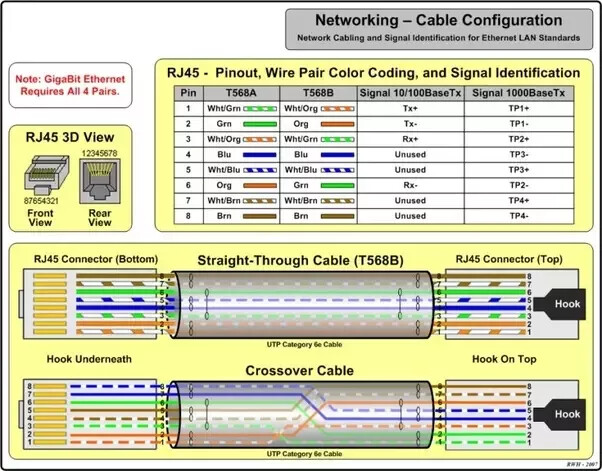

Depending on how far you have to go, you could add a differential line driver and receiver to a CAT5 cable and extend the TTL signal. Then put the USB converter at the other end?
Thanks I’m looking at the tutorial now. Not understanding much of it unfortunately. It seems to be only useful for Linux?

Although I have cat 5 cable to where i want to put my PC it’s used for the Network so no actual spare cat 5 to that point.
ah, so the small PC is running a Microsoft OS. There are a handful of commercial USB-to-IP software and hardware solutions for Windows. The hardware versions seem to be in the $50-$200 range and software in the low end of that. A quick search turned up an open source implementation for Windows but I have no idea if it works or how well it works. Linux-only PCs here.
In your network setup do you have any spare pairs you could use?
