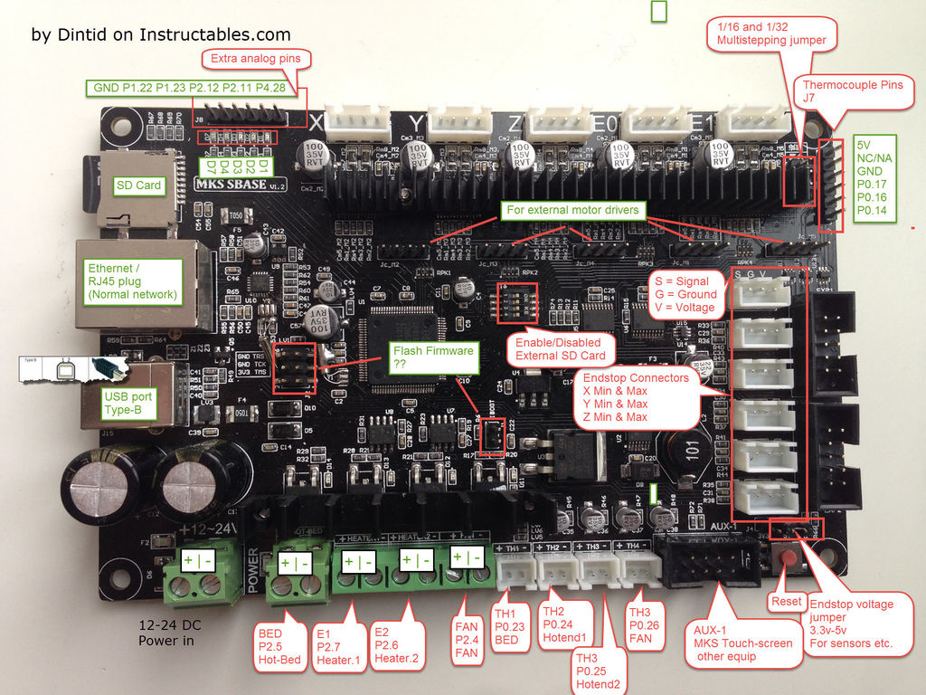

The description on your link is WRONG for grbl-LPC. We have PWM on pin 2.5, which is the big MOSFET (leftmost). And you don’t need to unsolder any led.
so i just move same L wire on that pic to left connector of bed heater, + one ?
ok for psu to leave 10amp or to use 21 amp ?
No, you need to connect the L wire to the right pin (-) of the bed heater connector. The mosfet pulls the L wire down to GND to fire the laser.
A 12V/10A PSU is far enough to supply the board and all the stepper motors.
Do not forget to connect GND of the MKS board with GND of the Laser Power Supply.

Use the - pin of the MKS power in (12-24V) connector (where you also connect your PSU GND).
aah so i get ground and negative to negative in mks board ,and from laser psu ground to ground
can i strip a bit that wire and weld these two and heat shrink isolate and connect to board ?
@ccfly Yes, you can do that. Just make sure the GNDs of PSU, LPS and MKS Board are connected.

i did all you tell me laser psu gnd to board gnd to board - on 12-24v socket
then L to 2.5 - socket
by this image 2.5 is near power socket and - on that one ??
then tape to middleman and i connect wires
i guess estY go to y S left, 5v to V right , G gnd right same for x estX for endstops
sockets are marked SGV
S left is signal G mid gnd i guess V right 5v
is that ok ?

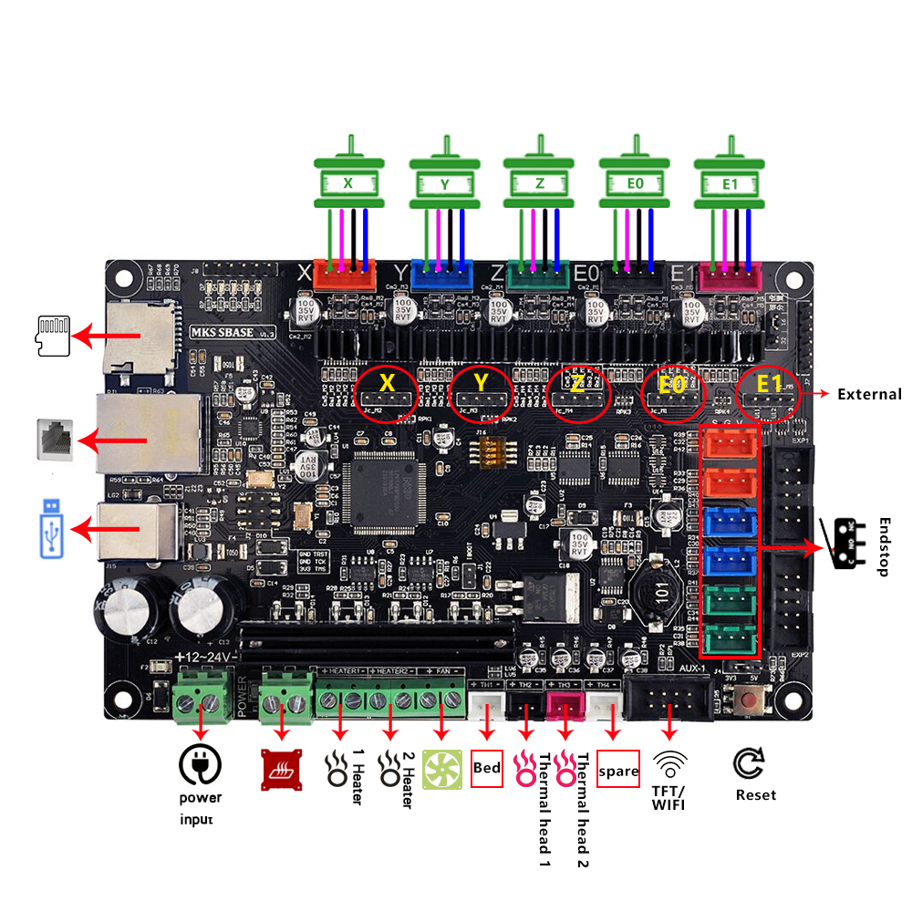

and x motor to xa- xa+ xb- xb+ marked to board
in which order to connect xa- to xb+ in board ?
from schematics from X letter on right pins are marked
2B 2A 1A 1B are 1AB minus or plus ?
i find this so by colors
can i connect XA - in green + pink and XB- to black + blue ?

so to connect x-motor socket like on that schematics from middleman board ?
looking from left pin on x-mot socket
xa- ,then xa + xb- xb + ?
or like on lower one xb- xb+ xa + xa - ?
and pwm ,p 2.5 is on - ,hotend socket just next to power 12-24V ?

If I understand your question correctly:
The middleman schematic above has the correct pin #s but does not intend to show the physical connector orientation on the board. Ignore that diagram.
The drawing of the smoothie does intend to show connector orientation but that is not for your board so ignore it also. Use the photo below…
Just pay attention to the labels (A+,A,-B+,B-) on the middleman board and wire to the controller X motor plug accordingly.
Controller to X Motor connections:
Controller A+ >> middleman A+
Controller A- >> middleman A-
Controller B+ >> middleman B+
Controller B- >> middleman B-
PWM
If you are using the BED for laser control then wire hotbed- to LO with an associated grnd:
Controller Hotbed - >>> LO on laser power supply
[Hotbed - is the rightmost screw on the left lower screw terminal labeled BED]
[LO is the rightmost pin on the rightmost connector on the LPS]
Controller Gnd >>> Gnd on laser power supply
[controller gnd is the rightmost pin on the lower leftmost screw terminal labeled +12-24DC power instrong text
