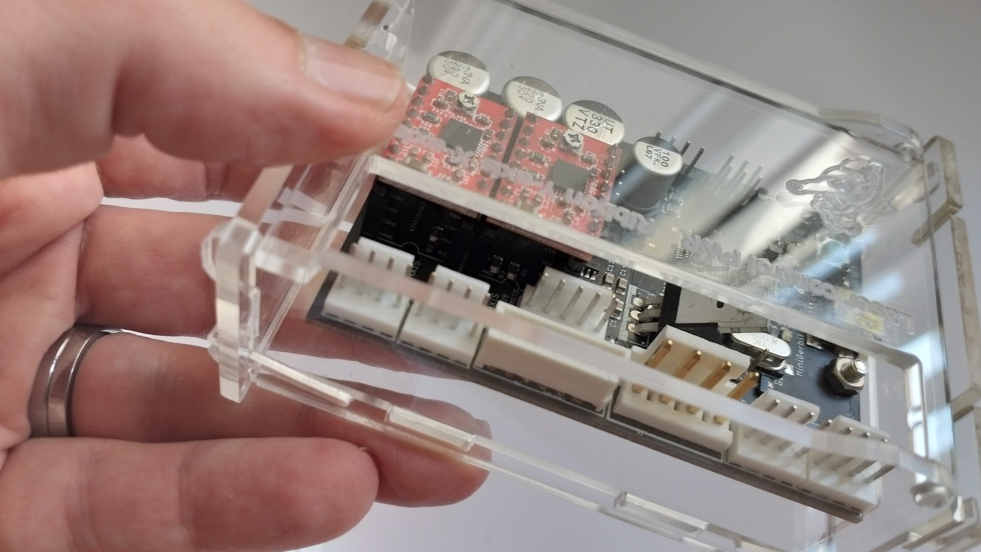

Have you looked at the awesome tech mini Gerbil controller? It’s cheaper than the c3d controller but it only does 2 axis (x,y)
The miniGerbil uses GRBL-Stm, but is as good as GRBL-LPC so that is not an issue. It is a plug and play, drop in controller with all the correct connectors for the K40. I have one and like it, but its only limitation is that you can not use it to control a dedicated rotary attachment or motorized Z bed.
