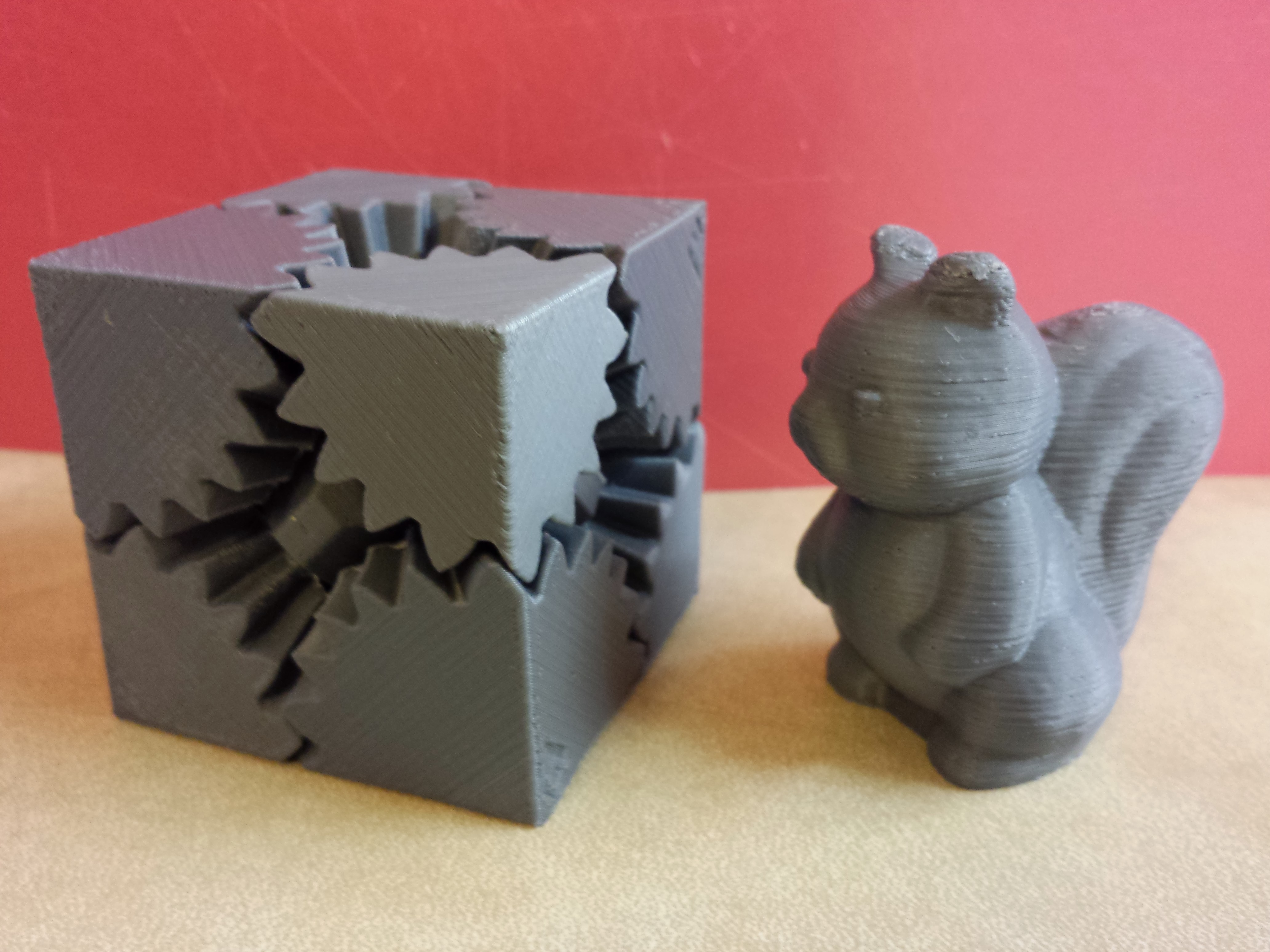

Wanted to post a quick status update on my large scale printer project.
Wanted to post a quick status update on my large scale printer project. Things keep dialing in more each print. I just finished my largest print to date. 10" tall vase.
Still not perfect… But better each time. Also everything pictured is ABS. I have decided I like it better than PLA for now. That is until I can figure out why PLA always jams my E3D and the extruder strips the filament on me.

Awesome job Eric! The parts are looking great!
