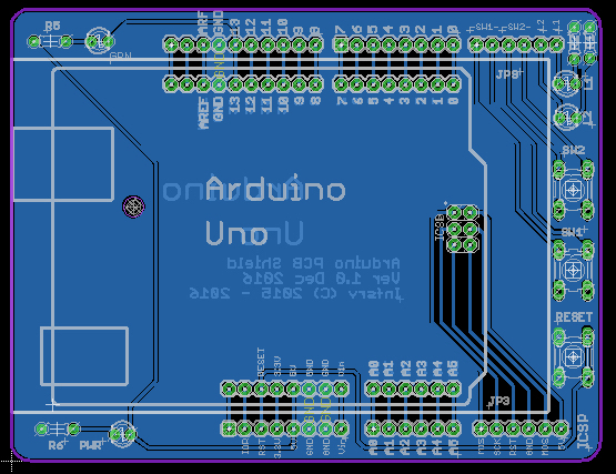

Wanted to share how the CP Eagle widget has simplified designing, milling and building a PCB. The PCB is an Arduino shield that holds a breadboard.
Less than 4 hours of work time I went from Eagle to Chilipeppr to Solder then using it. I also did this using a single .6mm endmill. All thanks to the CP Eagle widget, Ameen and of course John.
The circuit is simple, the point being here, is the speed at which you can design and create a working PCB at home.
