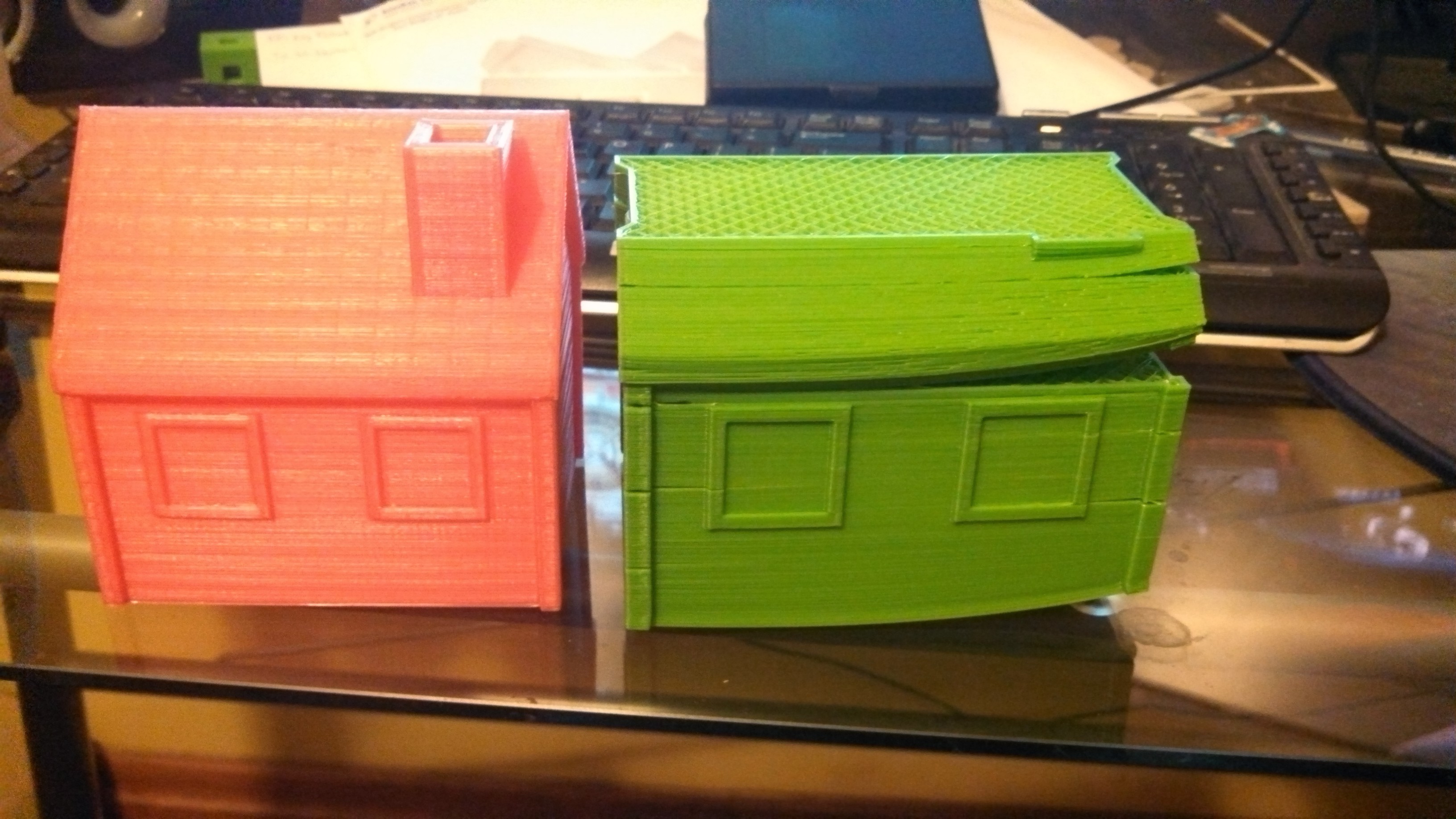

Wanted to share my conversion from ABS (green), to PLA (Red, but looks pink).
Wanted to share my conversion from ABS (green), to PLA (Red, but looks pink). I wasn’t a huge fan of the translucence, but it’s hard to argue with that print-ability. Our house has been rather cold lately, which is why I was getting huge d-lam issues and warp.
Also, I have no idea what happened to the roof of the house, it was printing overnight and I ran out of filament :wink:
I’m excited to print some bigger objects now with PLA! It also has the added benefit of a much better odor (although I can’t really smell ABS, my wife is sensitive to it.)

Mine is not enclosed. Which is another reason the difference is so drastic.
? I’m referencing the 1st post in the thread, which contains the photo… because my printer was not enclosed I was getting layer delamination with the green abs. When I changed to the red place, I had better later adhesion and part quality despite not having a heated enclosure.
