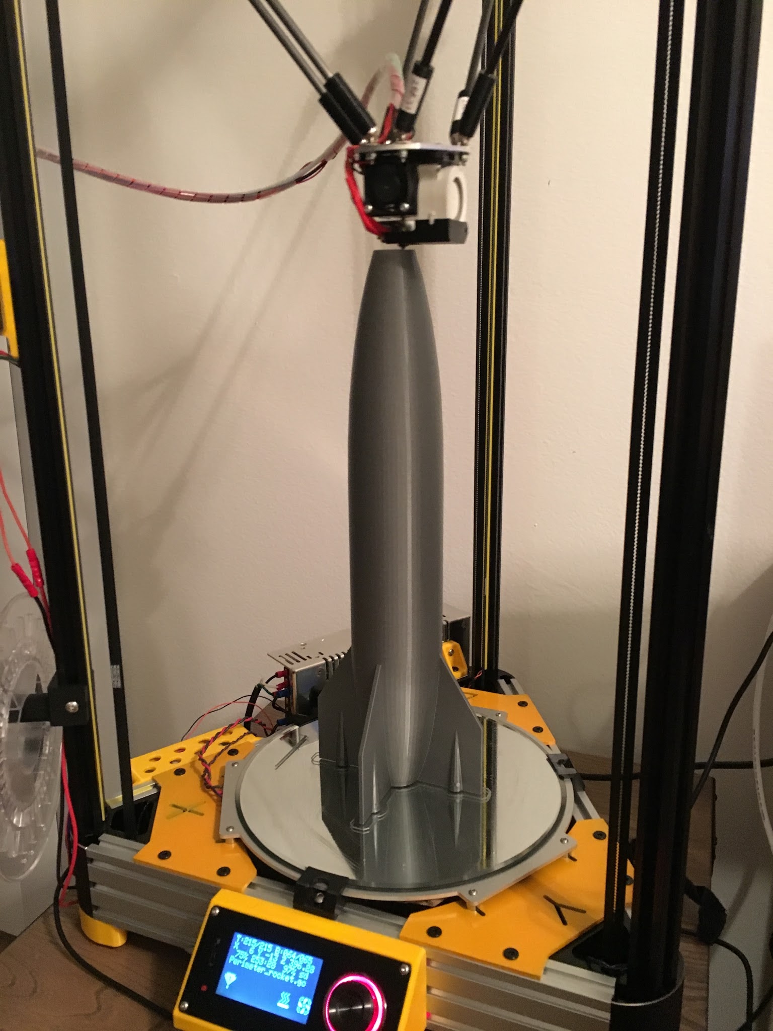

Wanted to try and use most of the Z-height on my Tria and do it relatively fast. Single perimeter spiral print in Colorfabb PLA/PHA. 40mm/s, 215C, and 80% cooling for the entire print at 0.2mm layer height. In total it took about 4.5 hours and is 430mm tall. Surface finish is impeccable everywhere.
