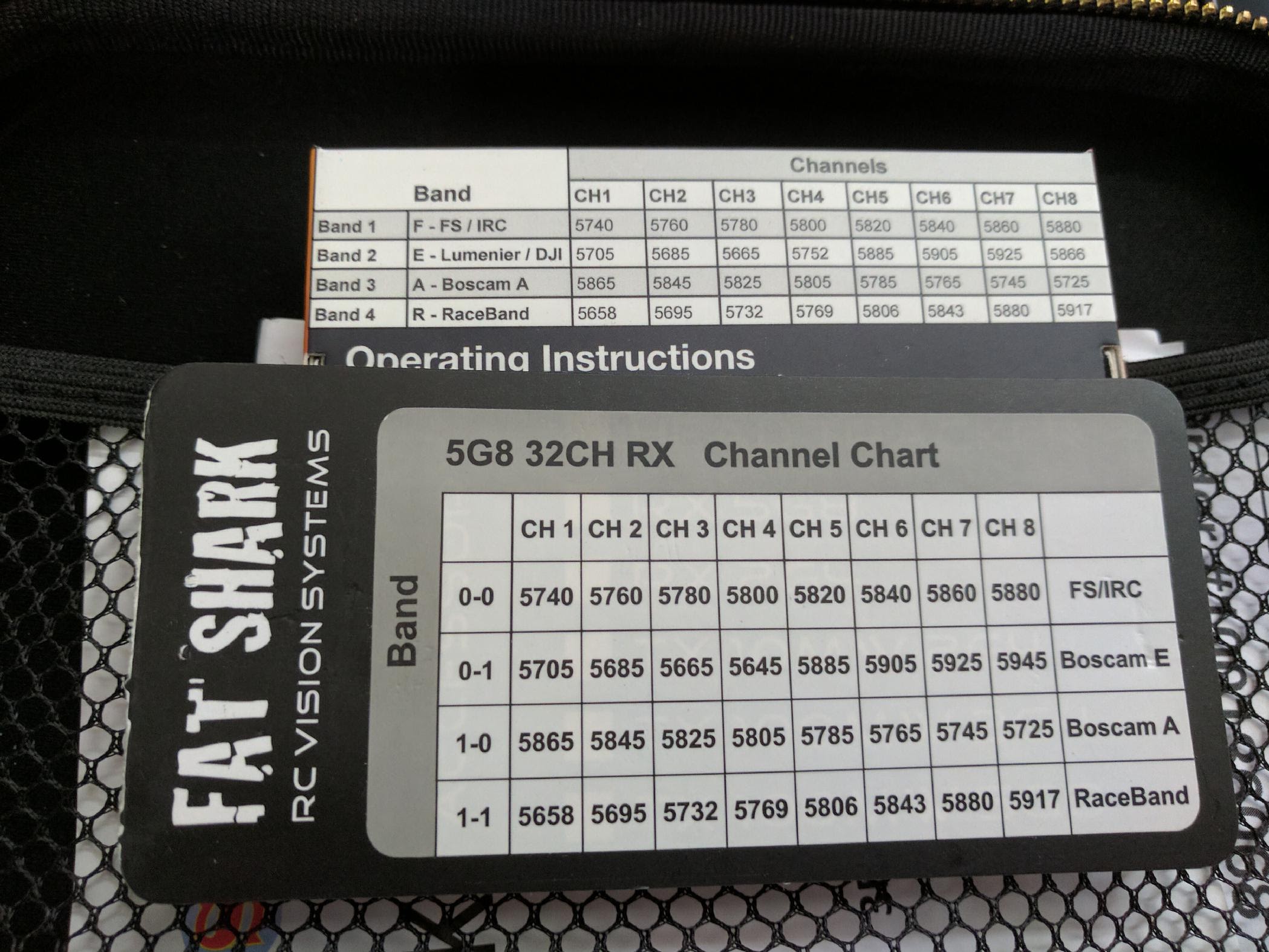

Warning about Lumenier 5.8Ghz Video Transmitters: In their inifnite wisdom, lumenier made a channel called ‘E’, a lot like the ‘Boscam E’ that I find on my 6 other VTX and 5 other FPV googles, except not really.
6 of the 8 the channel numbers on their E match boscam E, and the other ones are totally different frequencies.
What kind of madness is this?
I caused a poor guy to crash after he lost his video because I checked that E8 was free, booted my newly installed lumenier on E8 and it came on a channel very close to Boscam E1.
Seriously Lumenier? What were you thinking?
Check the frequencies on lumenier E on the top table.

They took out the two edge frequencies, allegedly because they might be out of range for some? I’m not sure that’s true though, especially for a HAM licensed user.
So there are actually two variants of the E band and they are not the only ones using this version of the E band. Ran into this before and was similary miffed by it. One more reason to switch to raceband.
@Jaime_Visser damn, more than 2 E band with different frequency mappings? Well that’s not confusing… Although again, making a different E8 that is super close to and conflicts with E1 is just a stupid move.
