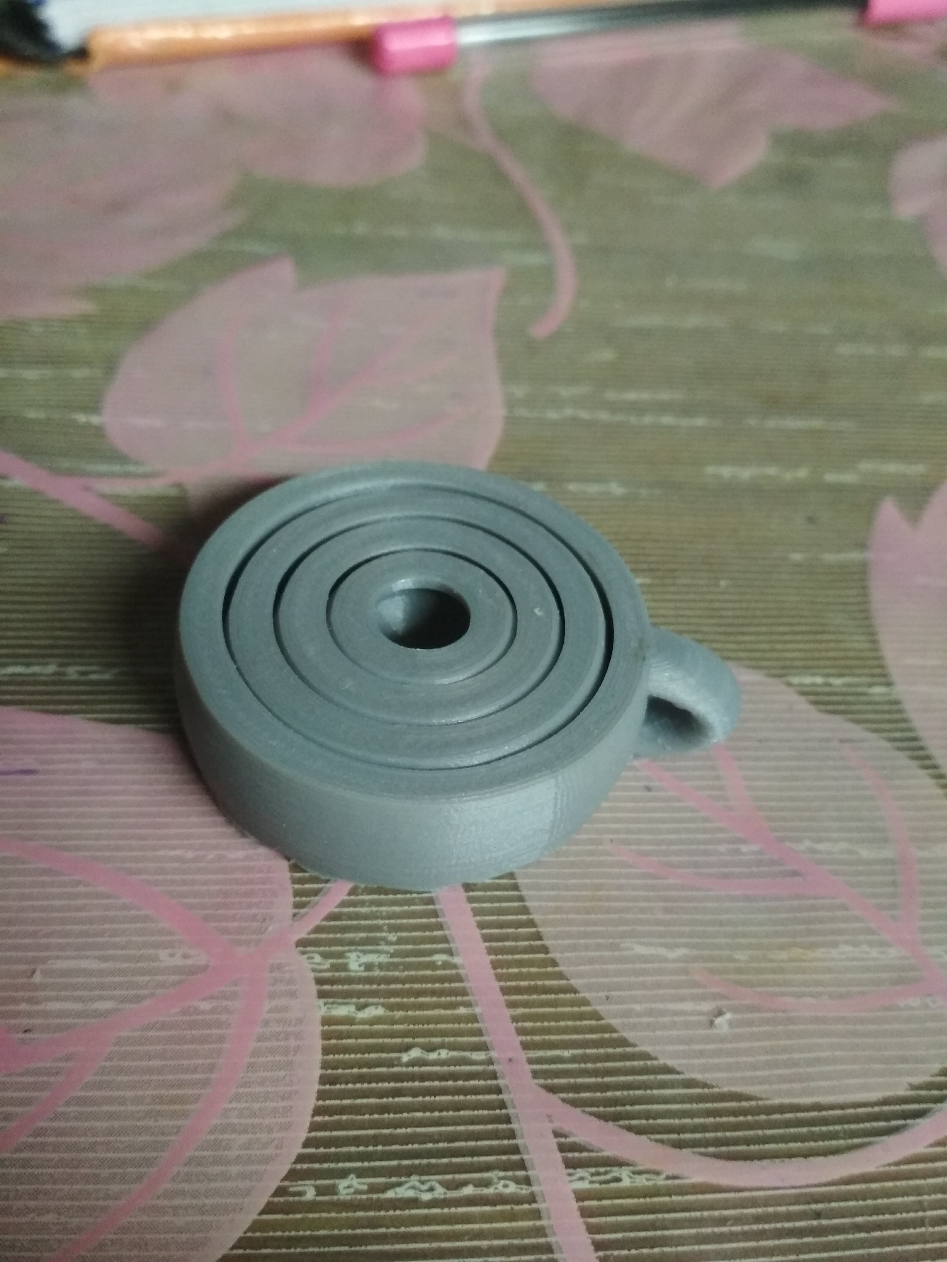

WARNING if anyone is planning to print this don't use a brim it will
WARNING if anyone is planning to print this don’t use a brim it will be extremely difficult to remove
Ouch. Collapsible teacup?
@Jamie_Frost gyro teacup
Use a stick through the center hole and you should be able to eventually work it free, I had to work mine and sanded it clean.
Are you printing on a shower curtain? If your print bed is removeable, just place it in the freezer, and the expansion difference of the two will separate the two materials

BTW this is the one: https://www.thingiverse.com/thing:644217
