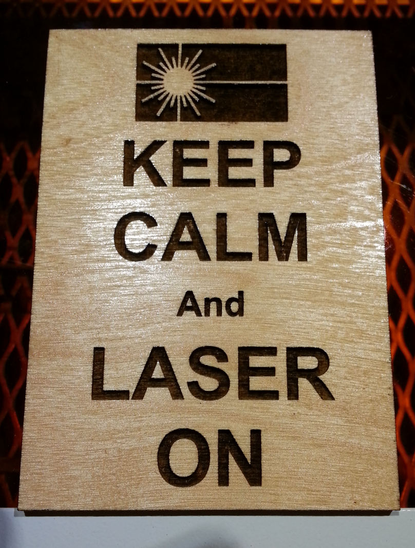

@StephaneBUISSON Thank you, it’s my pleasure. Ever since I got my laser my maker side has really come out. I love making things and the laser is really letting me explore new ways of making. Lol, I’ve got a sketchbook full of ideas I want to try. People like @Alex_Krause and @Yuusuf_Sallahuddin_Y are always inspiring me to do more. My moto now is Keep Calm and Laser On.

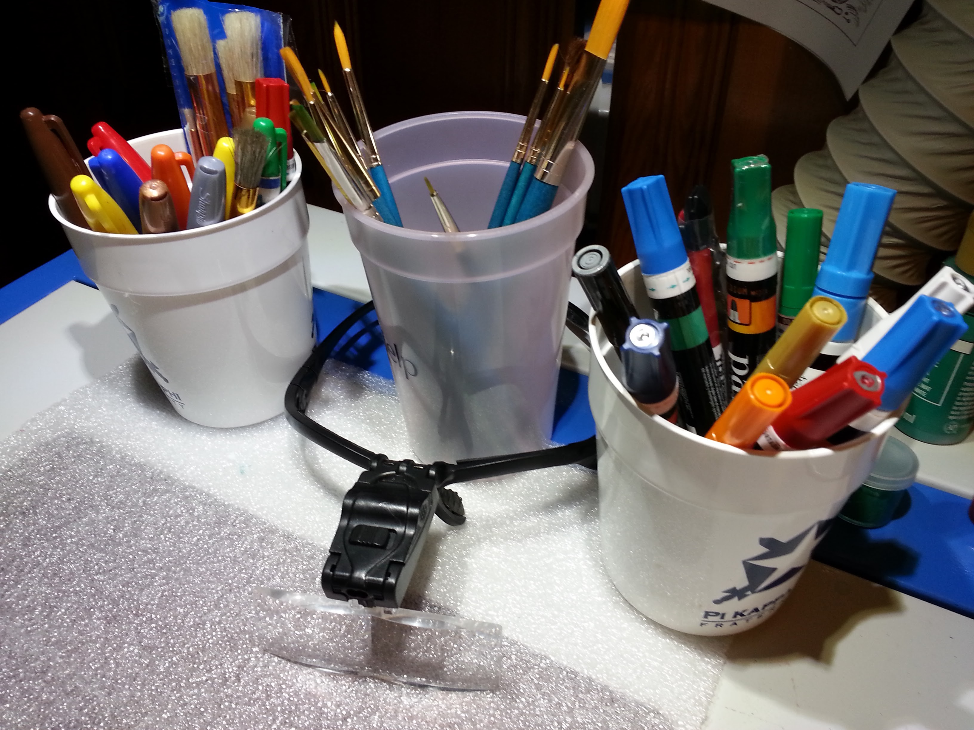

@Nigel_Conroy Thank you. Maybe I’ll do a more in depth post about what processes I use, but you can see my tools of the trade as it were below.
Basically If I can pre paint/stain before cutting /engraving I’ll do it because it always gives a more crisp and even finish. I pretty much mask everything I engrave to prevent the wood residue from staining the piece. Just makes clean up easier and when painting it offers you the ability to selectively remove parts of the mask while leaving other areas protected. If I’m going to do color infill in engraved areas I always like to seal the surface first (usually a clear spray) to help prevent edge bleed.
For some small detail, oil based paint markers can be fast and usefull but I don’t like them for areas that take more than a few strokes because it’s hard to get an even finish.
Sharpies are good for a wood stained effect and they are quick, but on larger areas it can be difficult to get an even finish. However you get some shading with them and it’s possible to even the finish out with a little brushed on solvent.
However for a lot of things it’s good old craft store acrylic paint. It’s cheap, lots of color options and easy clean up. For application I use good lighting, a head mounted magnifying visor (for detail work) and a good selection of brush sizes.
For the painted tag in this post it was done with a very fine tip paint brush and a steady hand.
It’s also on my list to eventually add an airbrush to my tool kit.

Thanks for the detailed respond. A very steady hand indeed.
You have a very good handle on the process and I for one would love to see a detailed post/video/tutorial on the subject.
