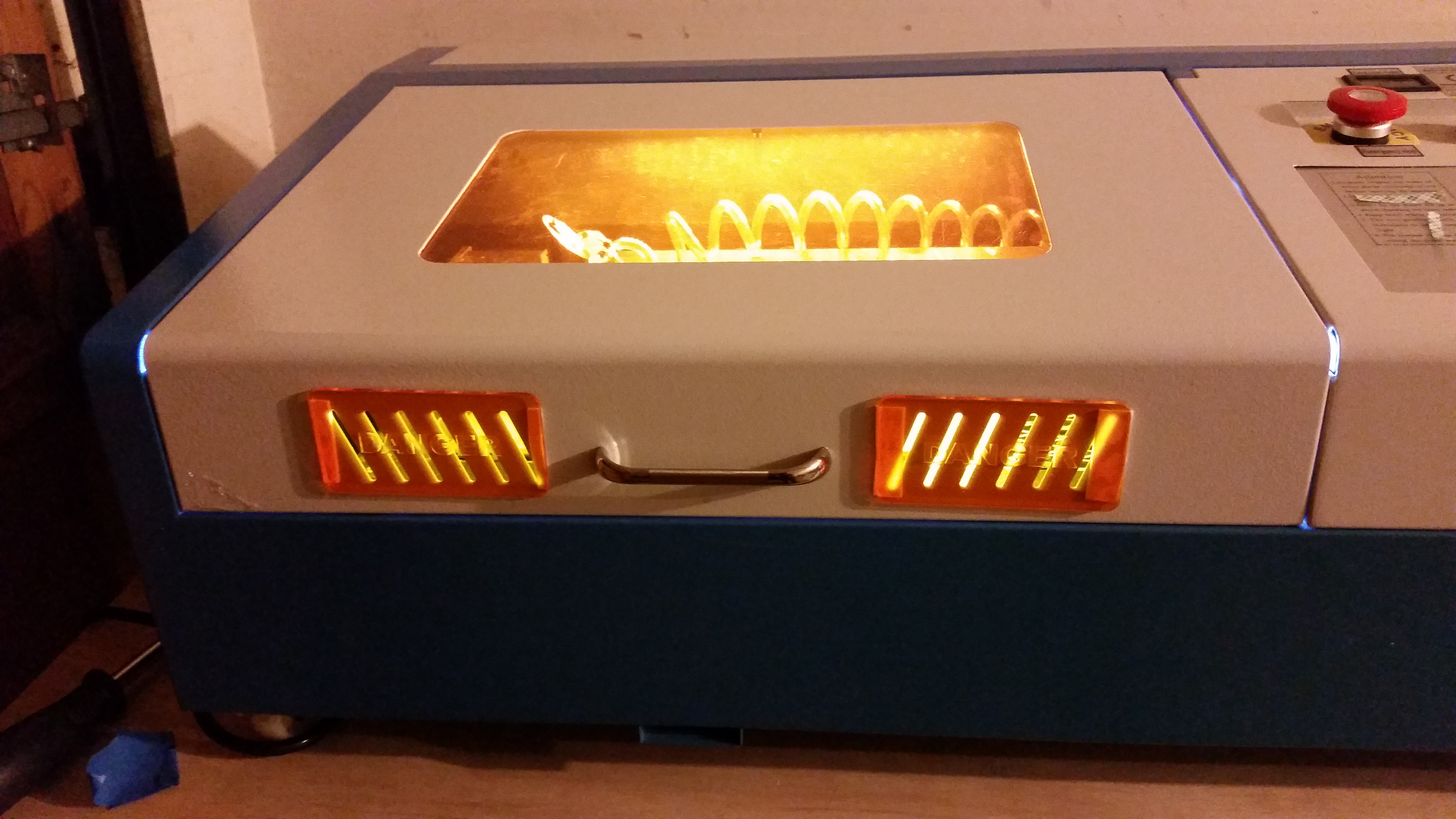

Was concerned with the open vents on the front (e.g.
Was concerned with the open vents on the front (e.g. stray beams making it through), so I cut some quick filters. Used thick foam double sided tape so it still gets airflow from the top and bottom.
