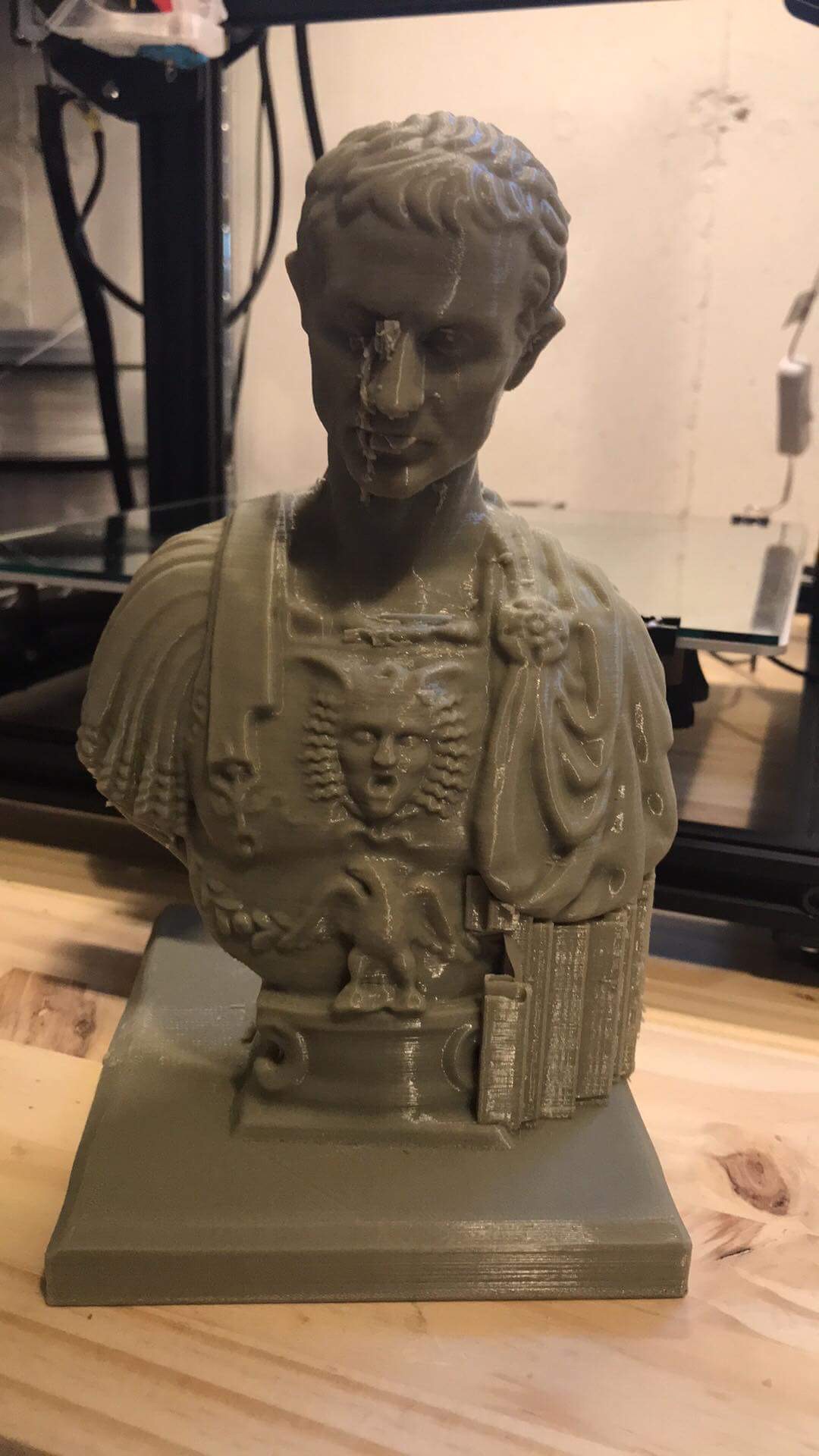

Was having the usual “clicking” issue with my E3D Titan Aero like a lot of people were having. I purchased a new small stepper from E3D and was using that. I followed the instructions, made sure the gears were all lined up, changed the voltage to my stepper and made sure it didn’t overheat, changed the esteps/mm… lots of reading forums to know to check all that stuff and still I was getting the annoying clicking. So finally after tearing it down for the 20th time I decided to try the old stepper motor from the extruder on the CR-10 and BAM!!! That was it! It has been printing beautifully. Still have to dial in a couple things but no more clicking. I did have to reprint a couple of the mounts and ran into a thermal runaway issue from having the part cooling fan blowing on the heating block. A quick fix in fusion and that fixed that. Super happy with the way it’s printing now.
