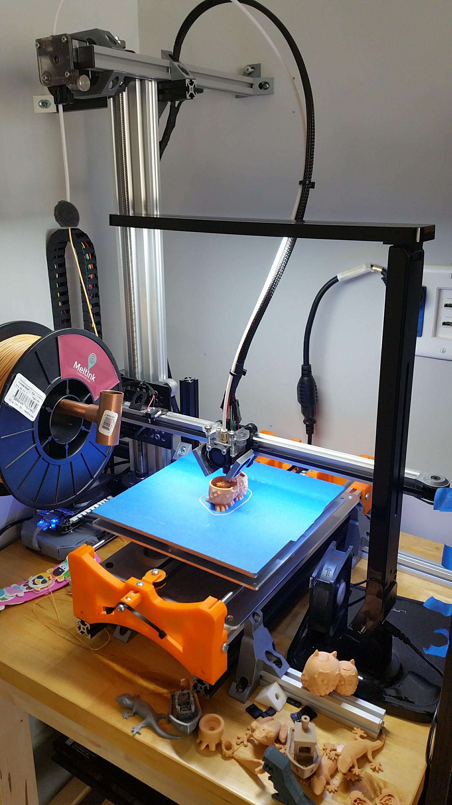

Was trying to troubleshoot filament grinding issue, the titan tension was good.
Was trying to troubleshoot filament grinding issue, the titan tension was good. The grinding start when multiple rapid retraction occurs. Initially I have the retract length set at 7.5mm and adjust down to 3mm better but it still grinds during retract. I then stopped the print manually and try to push the filament by hand, as suspected it would not extrude by hand
The @Deltaprintr ​ is mini and I did notice that while loading the filament it is very hard to go pass the brass push fit connector. I suspect this is the culprit.

From what I have heard that hotend can have a tendency to jam if the insulation sock is pushed up too far. There needs to be air flowing across the heat break (3dprinting Nerd mentioned this on one of his reviews). So you are probably seeing back pressure related grinding because the filament is having resistance at the heartbreak.
That description make sense as it did not start jamming right away… It would start at layer number 7 or so… Will check the insulation placement
Although if I print something that has little to no retraction it would seem to perform ok
Insulation has been like this the whole time.
@Shai_Schechter ​ what is your recommended retract length?
We use 4.2mm retraction, but that’s because we have a bowden tube. 7mm retraction will cause a jam.
