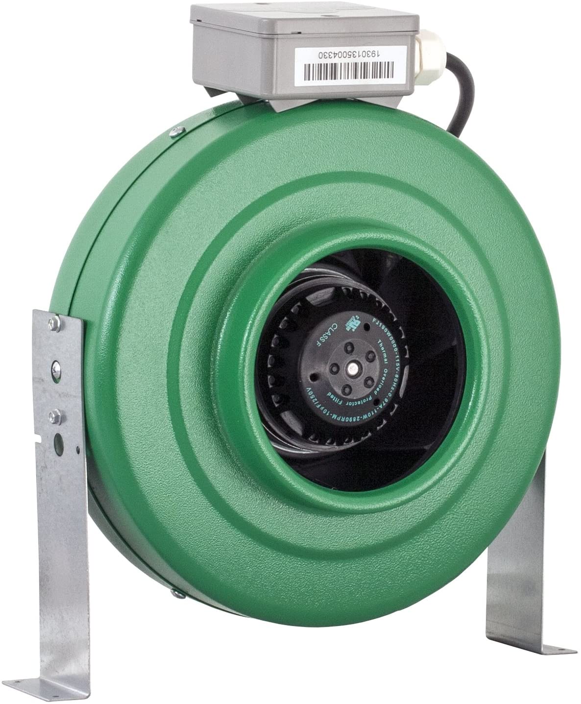

You mean I can’t fire up the laser and getting it lasing and then spray down the LPS with flammable liquid? :slight_smile: Will see what it looks like but considering it is inside the enclosure and I always run a large exhaust fan with the vents on the LPS side clear/open I just don’t expect much in there which would blow off with air. But if I can run it with the cover off that might be telling.
