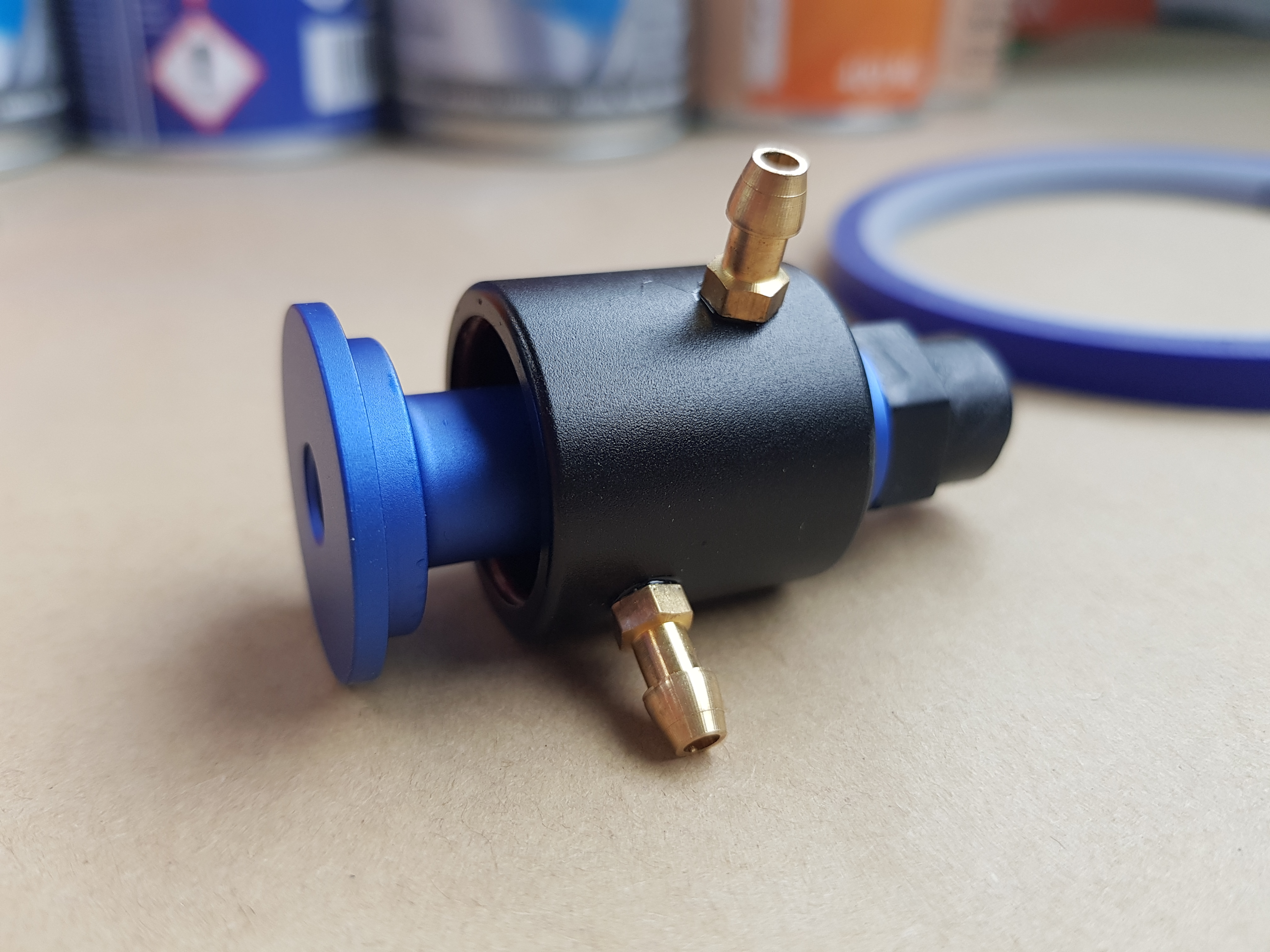

Water cooling is cool, literally. The jacket for my wcv6 from @Rene_Jurack came today.
Black matte beauty :sunglasses:

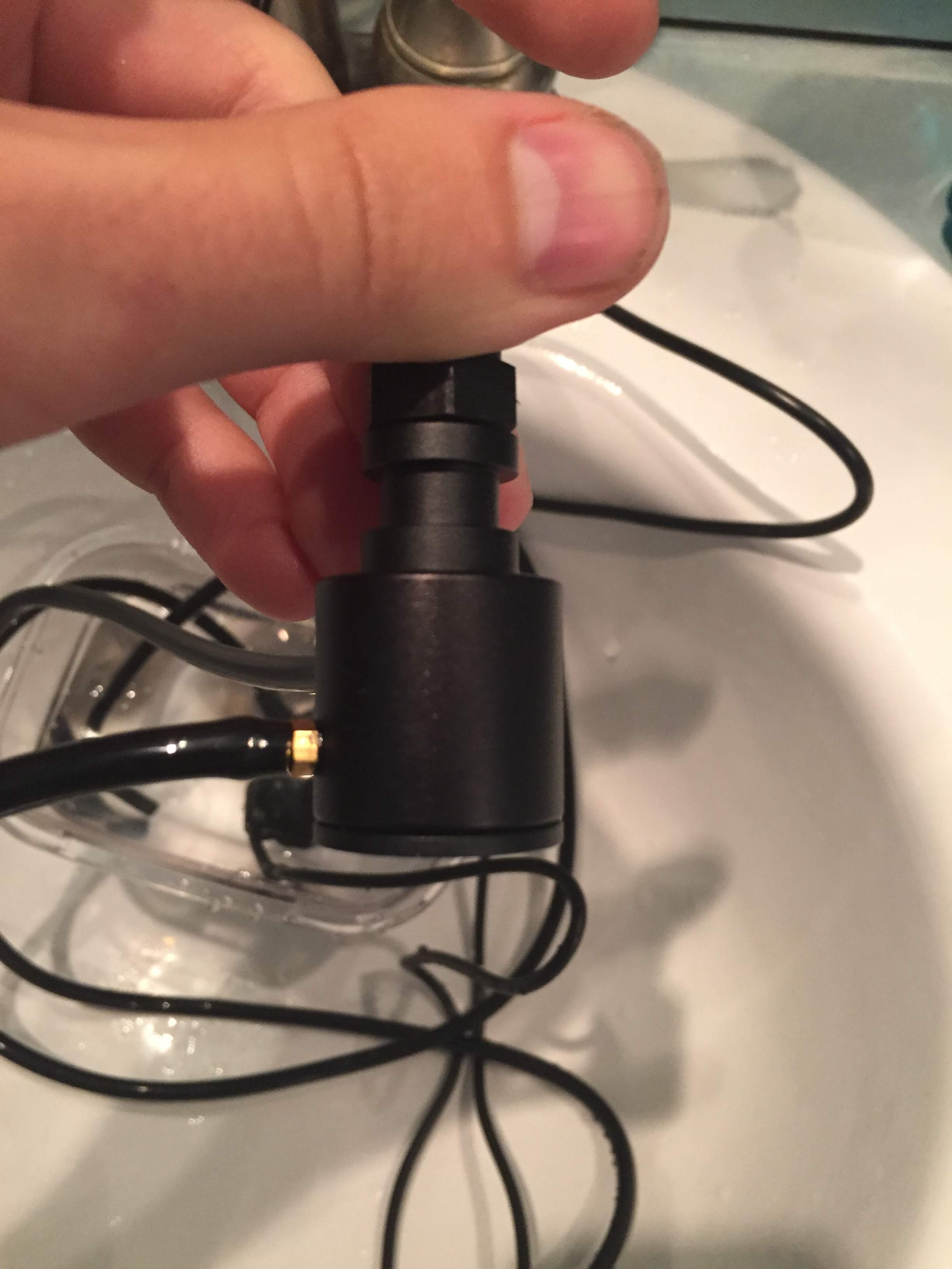

@Christian_Meiser Make the sealings wet before re-fitting the jacket. Otherwise you are going to damage the sealings.
@raykholo It will work, I already did it. Please mix the car coolant with water. Coolant alone hasn’t a good heat transfer rate.
