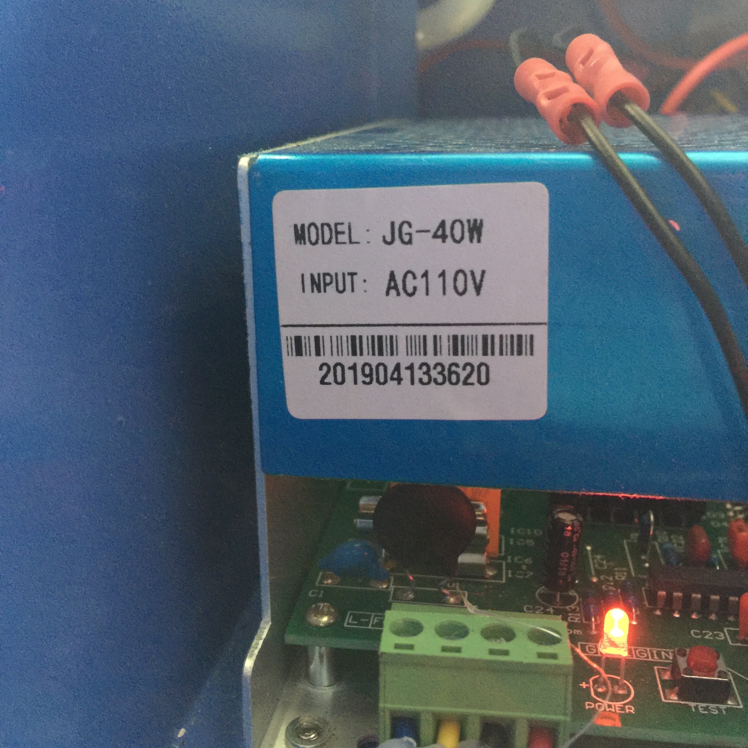

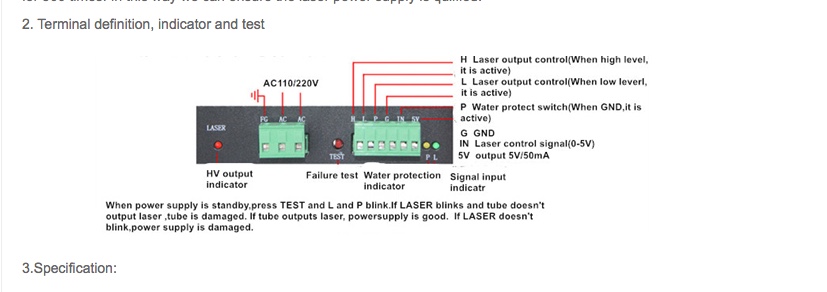

The replacement power supply came with this wiring diagram.
My question is the k+ on my old power supply = the “H” on the new one? Everything else is seems to be the same?
Thanks,
I have the power supply installed. Powered it up and the green light came on. Pushed the test fire button on the power supply and the laser fired. However, when I try to test fire from the digital control panel, it does not fire. Check on PS by grounding the L and it did not fire. The P-G have been cross wired. When I change the output values on the Digital Control the volts also change on the power supply. Is it time to replace the control panel or are there other tests to run?
