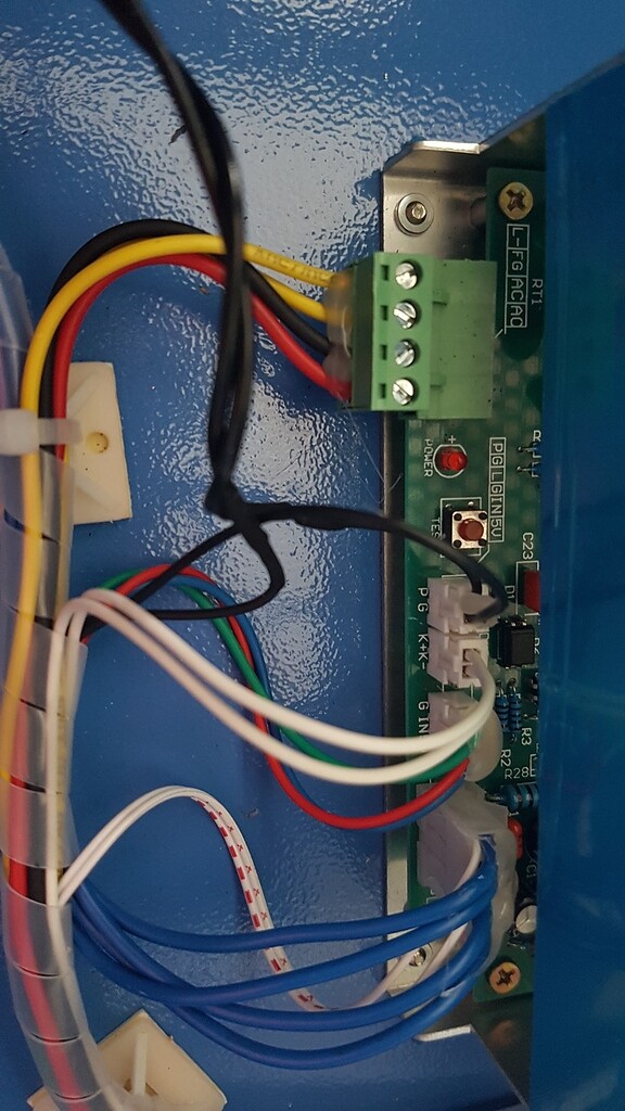

Here is my easy door lock solution:
So far :crossed_fingers: I’ve been able to remember to turn the laser power off before opening the door. But, this mod post has inspired me to do the same and make it fool and memory proof. Thanks!
You won’t regret it. It’s incredibly easy to forget that the laser is enabled when working around this machine. The beam being INVISIBLE makes you feel like it is safe when in reality you can be ms away from ruining you vision. This kind of damage to your retina cannot be corrected and at best you get permanently distorted vision and worst your blind.
Secondly getting into the 20,000 VDC high voltage accidentally can also be a lethal event (rear cover).
Unlike most tools the laser and the 20,000V are both invisible means of human injury. A user adjusting the machine can easily be exposed to an invisible beam reflecting from a random surface. So to the laser can be quietly firing and opening the cabinet and getting to close to the anode in the tube cabinet can result in electrocution. This voltage can easily jump > 2".
This protection is akin to using a push stick on your table saw vs exposing your fingers to the blade however the invisible ease at which this machine creates danger and the resulting damage from not being safe can be catastrophic. This is why machines that meet US standards of safety do NOT cost $400 they have well designed safety measures.
