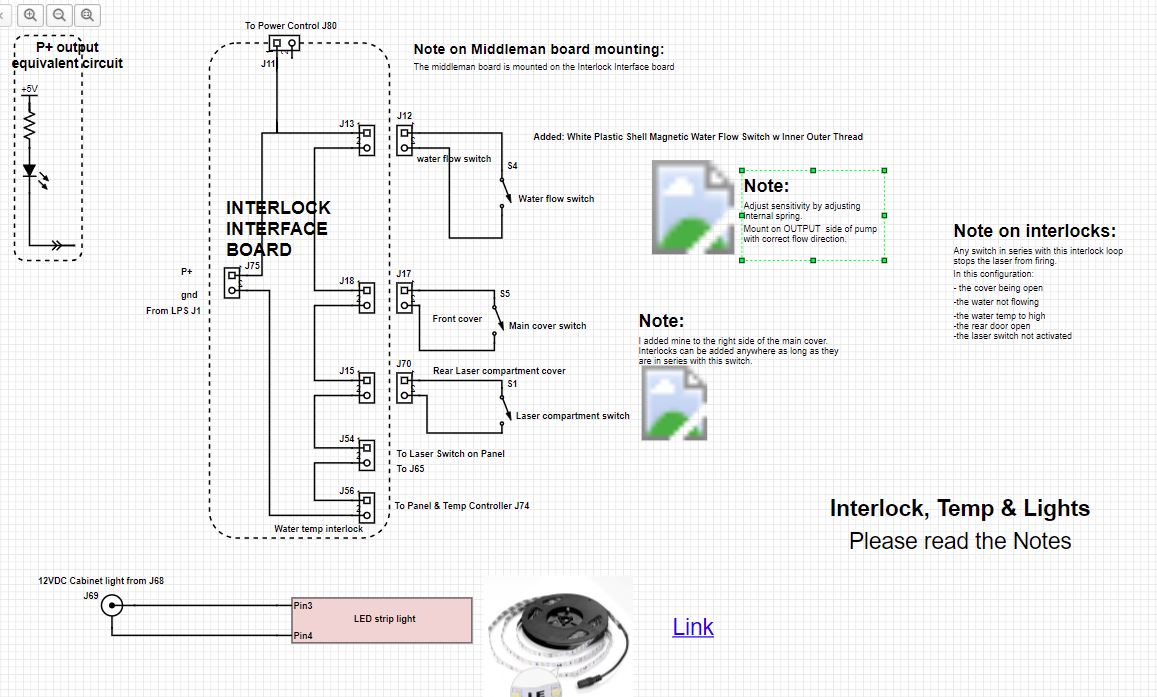

Mine has been running like the attached shem shows for many years…
I also was annoyed by the laser not firing not realizing the interlock circuit was open and this solved that annoyance.
I have thought about instrumenting the interlock circuit and other sensors many times and it never found its way to the top of my list.
Note that J11 just connects the LED on the panel.

@jkwilborn what’s the safety switch setup on a stock K50/big blue? As you can see from Don’s post, he’s added switches for the K40 main lid, laser lid, water temp and water flow. From what I’ve seen, the ‘factory’ upgraded K40’s known as the K40D usually only have a water flow switch. What do the K50’s come with?

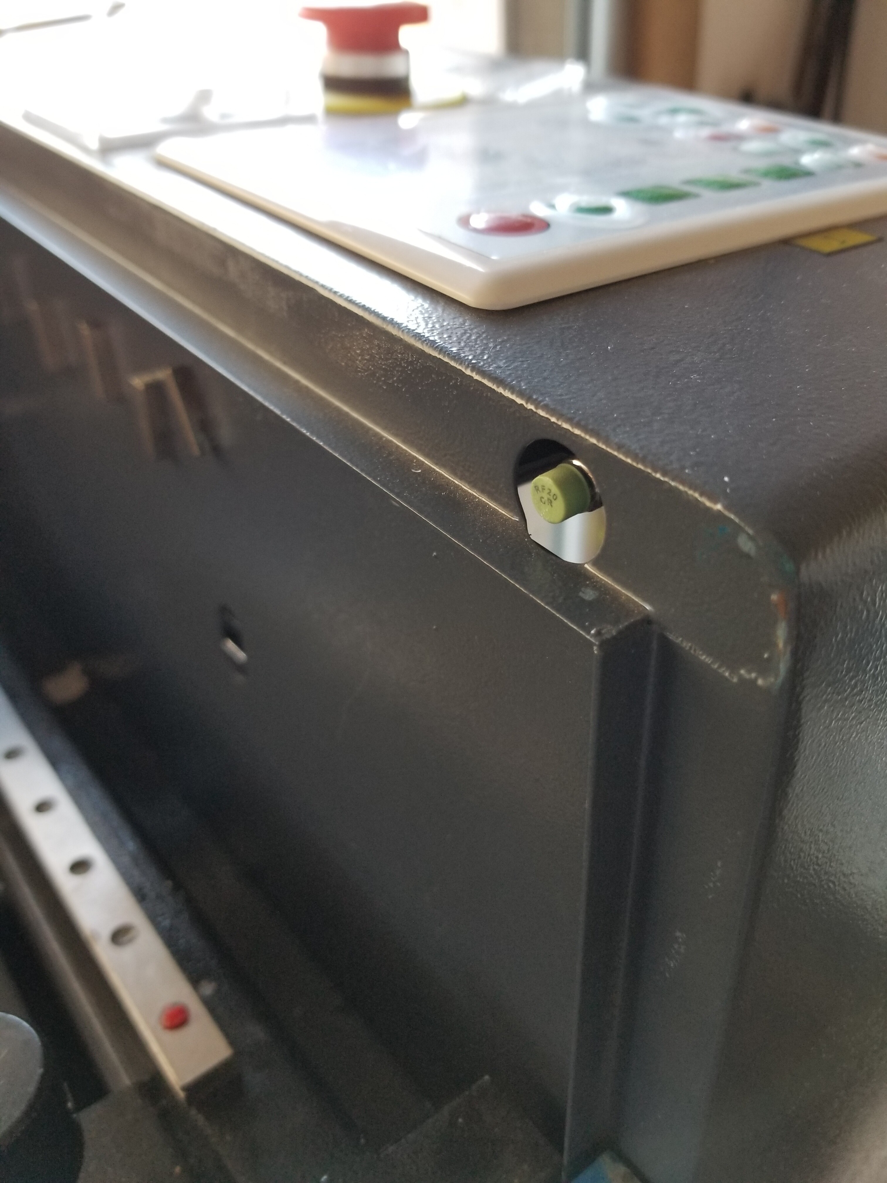

It’s a standard hall effect that senses the lid being shut.
