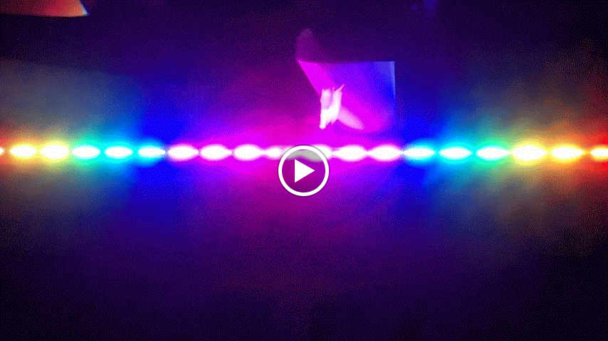

Wave with Hue Mask EDIT:
Wave with Hue Mask
EDIT: New link with NEW CODE http://pastebin.com/xKahEP61
OLD: http://pastebin.com/jXwNxmLz
could you share a .ino? curious as to the values you’re using. thanks.
wave_scale is set to a pot that scales from 20 -100
NUM_LEDS in my project is 144 LPD8806
is there full code for this to run on ws2811 strip?
@Synthetech The code is shared in the post, the link is at the top.
Thanks for the reply.
Sorry I’m still learning the basics of writing code…
The code you post is incomplete and won’t compile… looks like definitions, setup and loop is missing and I’m not sure how to put them in
I still cannot get this to compile… pretty sure the code is incomplete, also where I see LEDS.show, shouldn’t that be FastLED.show?
@Synthetech Well, I haven’t tested it on a rig but it compiles. Heavily commented so you can learn too: http://pastebin.com/xKahEP61
Thank You! I got it to work now. :slight_smile:
For my shorter strip, it helps to change the val ‘hue’ to a higher number for shorter strips. For 60 LED’s I found around 48 gets more different colors.
You’re welcome. Experiment with the wave_scale value as well. And, post a video link of the code flying high over head or something!
