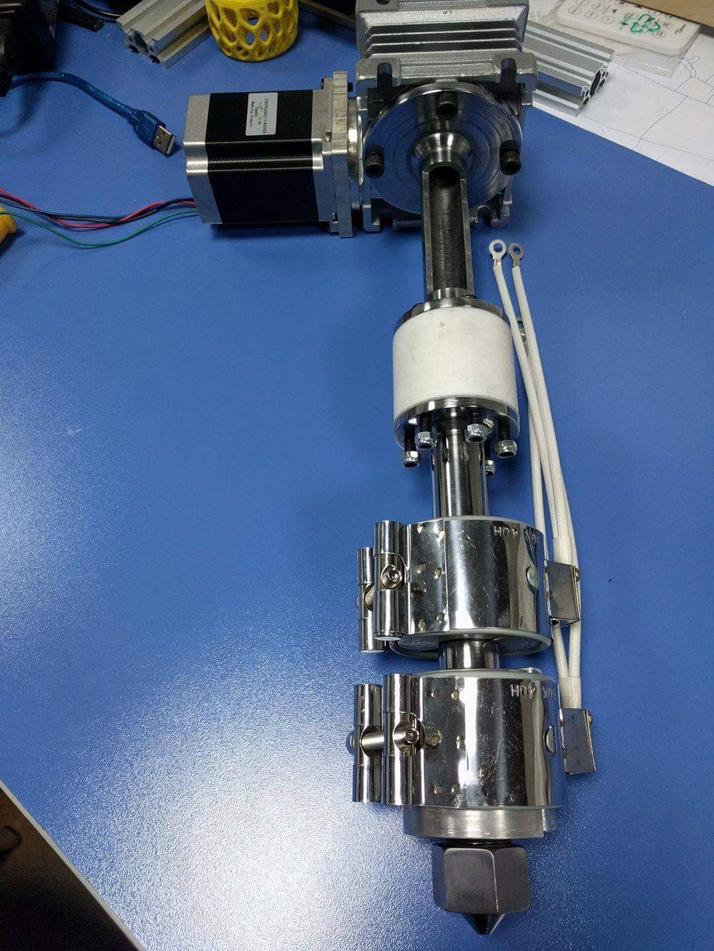

We are building a big size 3d printer (a university project). It will be cartesian type, 2m×3m×1.5m. Will use Openbuilds c-beams as linear rails, Nema34 steppers for X and Y, 6 Nema23 on wormgears with sfu2005 ballscrews for lifting the bed up and down (Z). This is a pellet extruder with 4mm nozzle (have exchangeable nozzles with different sizes). Tested with ABS pellets and working flawlesly. Extruder is the first “milestone”, so we passed it :smiley:

here is it :smiley:
@Zviad_Sulaberidze Looks great, is it for extruding filament or printing? Also, what is the estimated cost for this build?

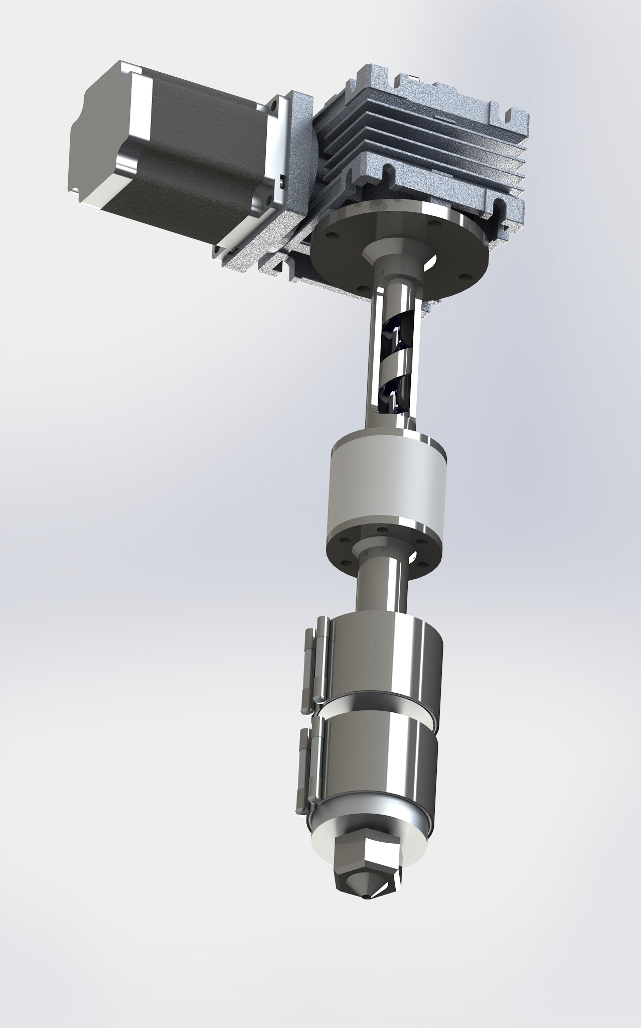

Please put a description on this post
I have updated the post

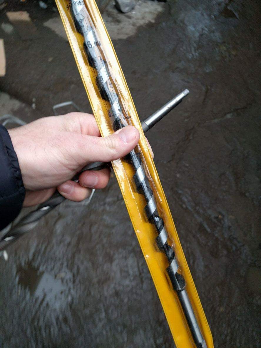

Is the screw progressive? What is the thermal separator made of?

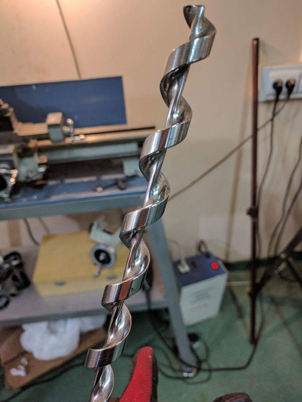

no, screw is a regular auger bit, but polished (original one did not work, had too rough surface in cut part). the heat breaker is a solid PTFE

I was able to hand grind a progressive screw from a concrete bit. From the little I understand, the commercial ones are progressive. I might be able to make one for you, if you give me measurements.
this is an original auger bit
and polished. This seems to working ok as far as we tested
Your extruder is vertical / down feed. Industrial ones are horizontal. Maybe that’s why it works? I really don’t know. Offer stands, if you’re interested.
thank you, will have in the sight. Those - horizontal ones act also as a piston, for injection so they have good pressure isolation with the compressed space, apart of the compressed plastic
