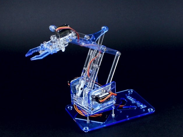

We have a K40 with Ray’s excellent Mini board at work and I was wanting to cut a meARM robot for Christmas for my son:
One of the things in cutting the design is the air assist blows the parts around. I was wondering how others have fixed this problem?
