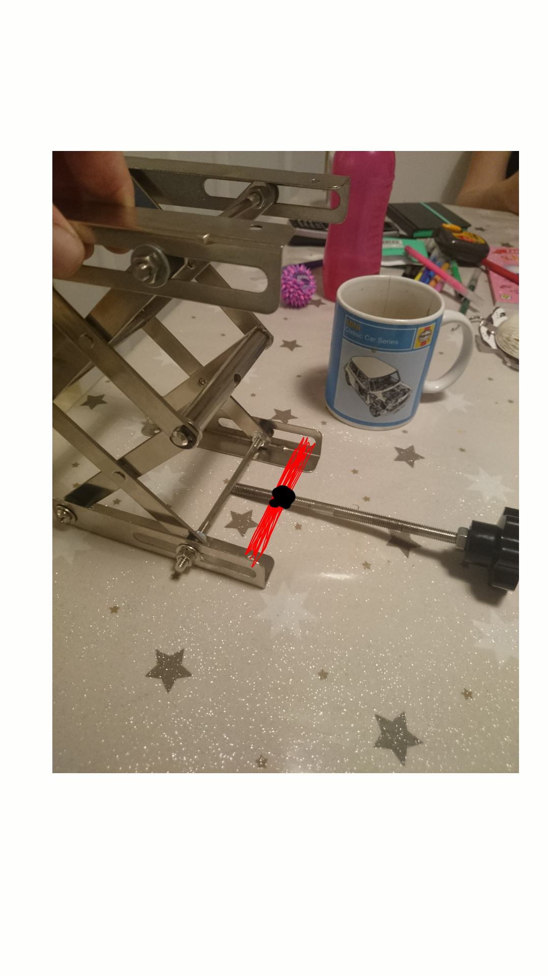

OK I’ve taken the thread out completely but the bars do not fit in the slots properly to drop them down but with a piece of m8 stud it should be easy to adjust the height on this.
I’ve placed the thread in position for the photo so you can see where I want to put it. Just need to get a welder out to mount a nut to hold it. The red line is a small piece of plate and the black dot the captive nut. The thread will push against the bottom bar and force the lift up while remaining at the same level.
Hope that makes sense.

I’ve mounted it in the cabinet now photo to follow, I just need to get a new piece of stud and I should have it all working.
