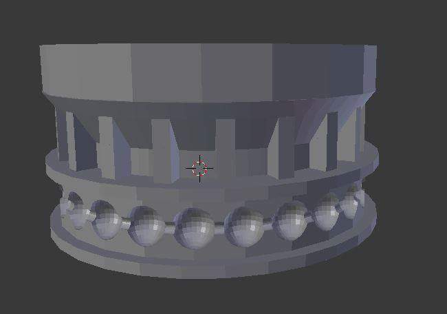

@Kelly_S That is so sweet! Did you modify the adjustable nut to accommodate the ball chain?
Well @Kelly_S I suppose you think your Flash out doing my attempt at the adjustable bed lol. Well done that looks great I love the simplicity of the ball chain.
@HalfNormal yes, I made a new adjustable nut with the same top as the original but setup for a ball chain. What’s nice is it works really really good regardless of the tightness of the chain, have the pully setup that there is always enough balls in the track to never slip, even when the connector goes around.

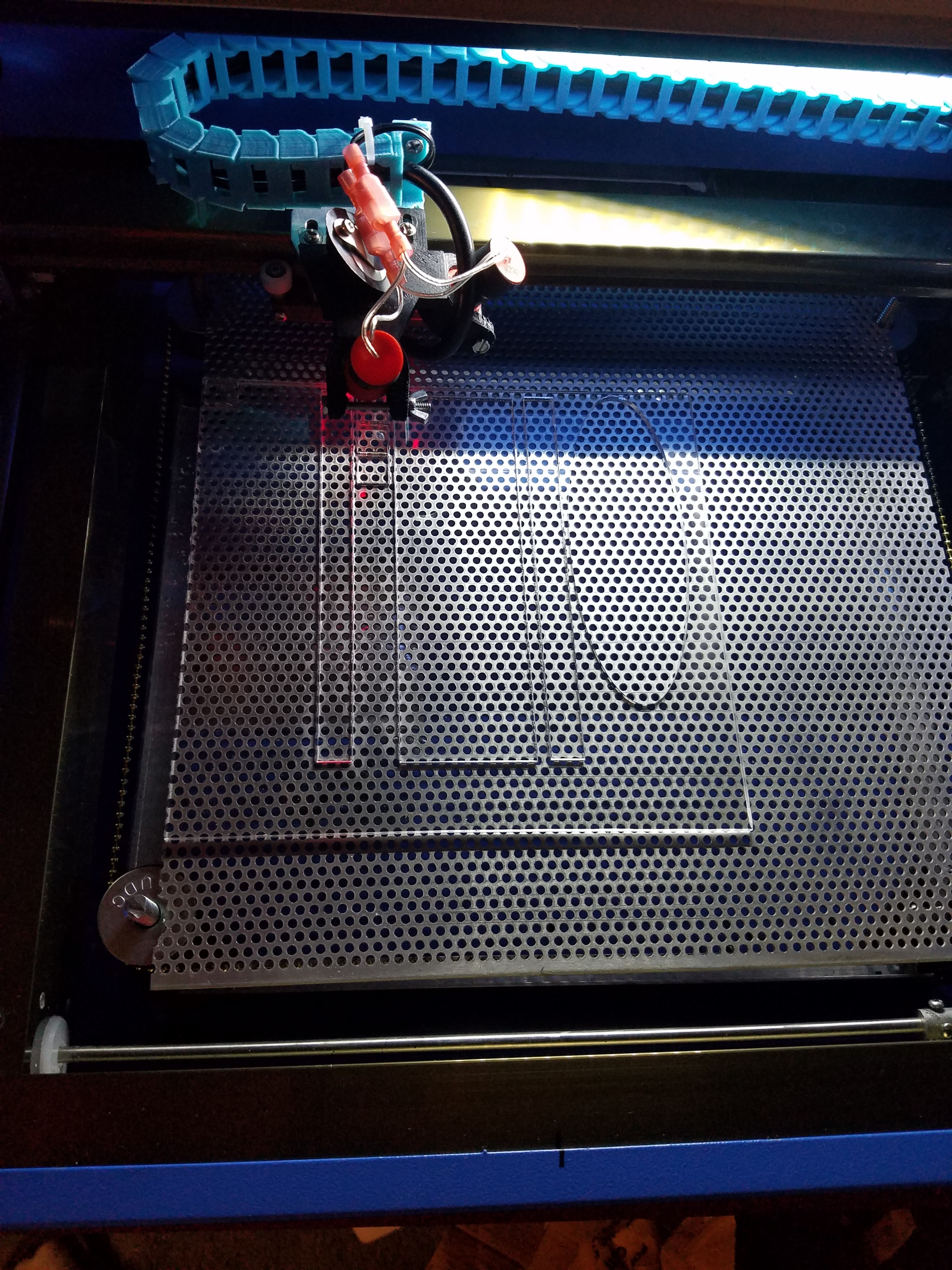

if I have a chance later today will add my remix to thingiverse. Expect my new aluminum bed tomorrow (48% open with holes, was a pretty good deal) will get it installed. And see how the movement is. If it binds will make sleeves to go through the bed, just tall enough to not protrude too far and that will fix that issues as well.

@HalfNormal that’s not a bad idea, I actually think just a washer alone would be fine. Will definitely try that when I get my new plate tomorrow and cut to size. The only spot I think it would bind is whatever sheet or plate is riding up and down the threads, potentially getting stuck on a thread. I think the best solution would be a spacer between the threads and the bed and your idea of a washer.
I also ordered these to put in my plate to get less surface area under my projects as I mostly cut, should make air flow really good.
