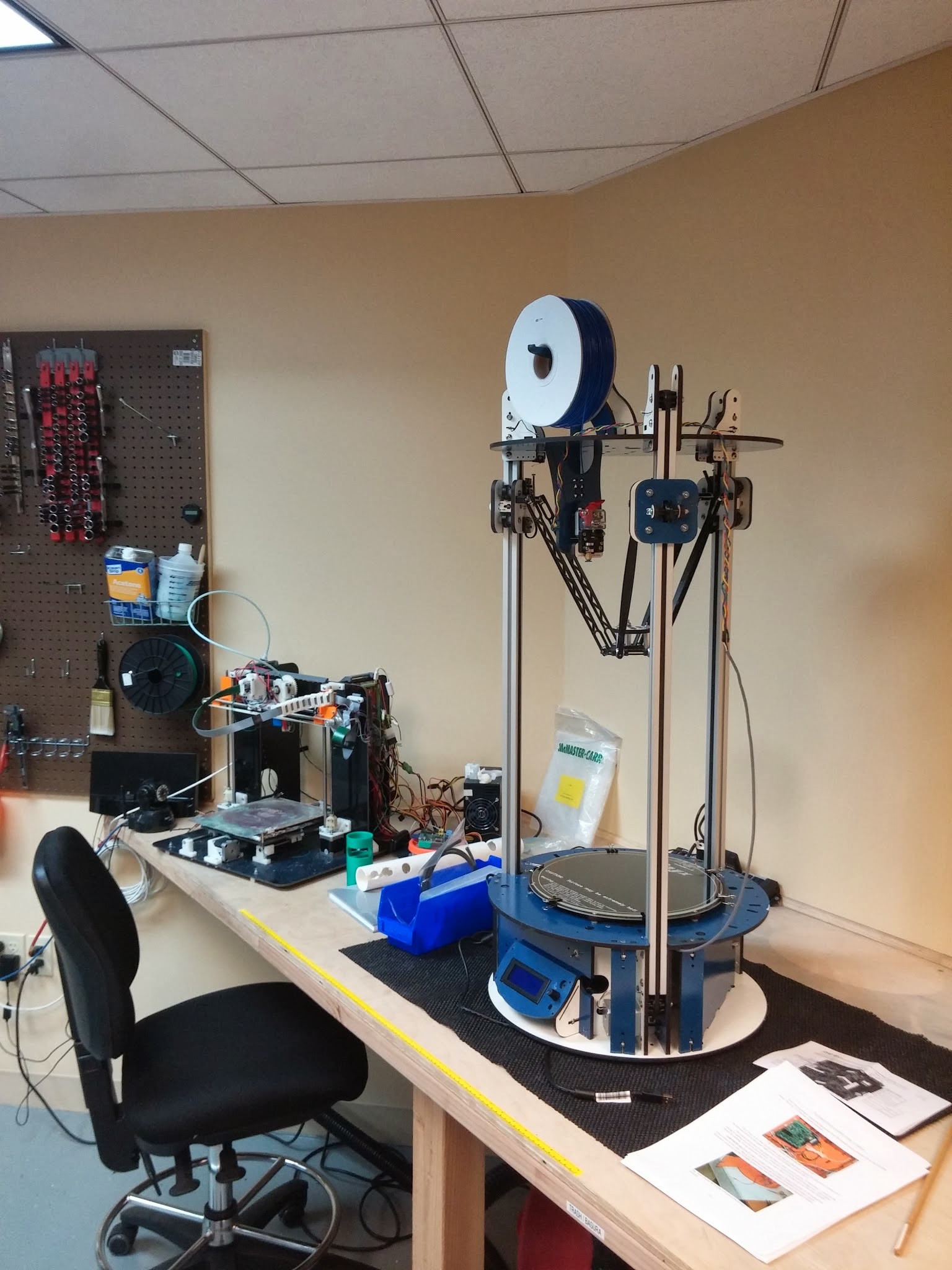

Weekend print-cave expansion - only hot-end install and calibration remain on the rostock!

Ok. That is one sexy machine. Did you need to purchase non kit components to complete the assembly?
@Peter_Zsiros it’s a all in kit from SeeMeCNC. $1k USD. Great deal. Needs upgrades, but what printer doesn’t? Mine is humming away right now printing some math toys for my little girl.
vibration reducers huh? is that the rubber bands between each pair of arms I’ve seen people use? Or do you mean actual carbon fiber arms? Supposedly the arms they ship with now are much stiffer than the older version, when did you get yours @Nathan_Ryan ?
I’m going to post a mini-review of the build & kit sometime in the next couple days
I got mine just after the first batch shipped out. About a year ago. Lots of the bits have been upgraded or changed completely since then.
But yeah, the rubber bands will do it. In fact the cf arms I have have the bands on them as well. I’ve also seen on thingiverse two clips bridged with a spring, which would be another possibility.
