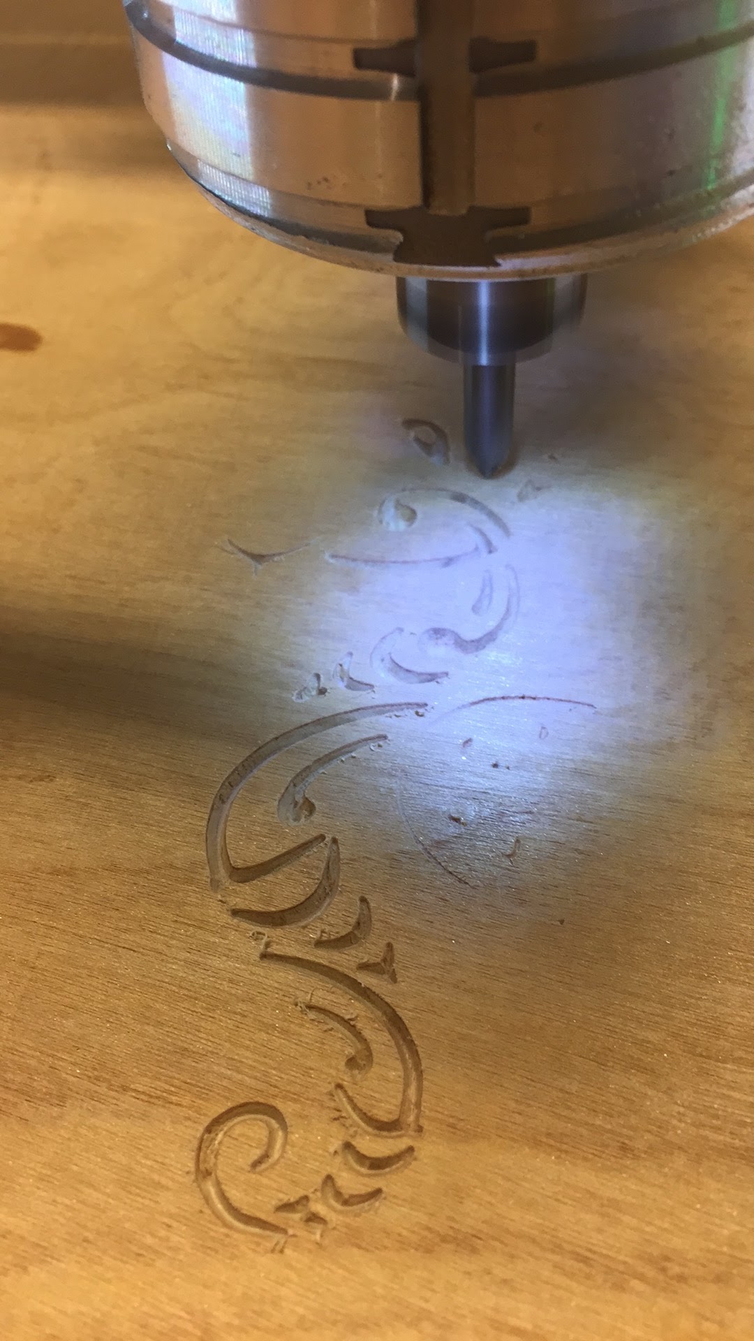

Weekend project(s). Small box my wife designed to hold wine toppers.

I have 16 more to cut (Which are still cutting right now). I’ll do completed pictures later when I get out of the garage.
The iPad Mini is connected to OctoPrint which is running from a RPi B+. I just took the ‘State’ section and broke it out to a separate page. Mostly to show status (Completion time and percentage left) and start/pause/cancel. Preloading the gcode is done from with-in the house. I just G92 the machine where I want it and hit start from the iPad. All jogging and such is done with a XHC HBO4 pendant.
Oh the CAM was done with Vcarve Pro.
