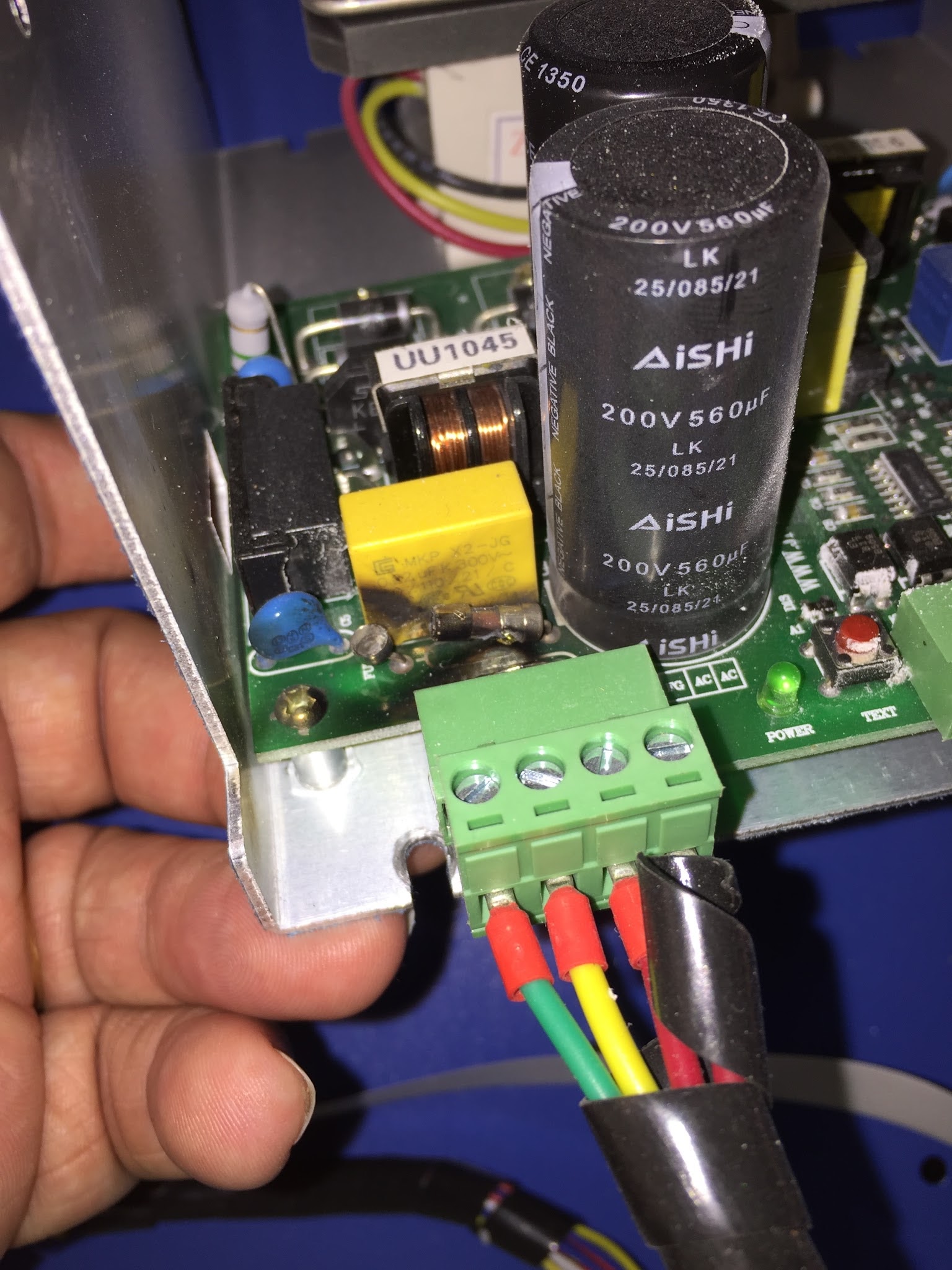

Well, After taking out the PSU and having a quick peek inside,
Well, After taking out the PSU and having a quick peek inside, I found the part that blew. A friend locally suggested that it could be repaired. I am waiting to see what the seller says first.
In the mean time, still looking for a second hand PSU if anyone has one going, perhaps after an upgrade? Get in touch. Original pic included and will delete the old post to save space.

Hmmm, I’m not 100% sure but isn’t the exploded part some kind of fuse or protection that blew? If so then the problem is not in that part but somewhere else in the circuit. My 2 cents don’t try to repair this thing. It is too dangerous to try to repair and use again. These PSU’s make very high voltages and require a lot of knowledge to build/repair. Just buy another one and be angry because this one… went down… :frowning:
That isn’t the first thermistor to pop.
NTC Part # 5D-15
Thats a thermistor ?
thermistor is missing. and the fuse is destroyed as well.
I can’t say what popped the fuse but being that the thermistor has vaporized there’s a good chance you can start looking there. after that make your way up to the rectifier.
