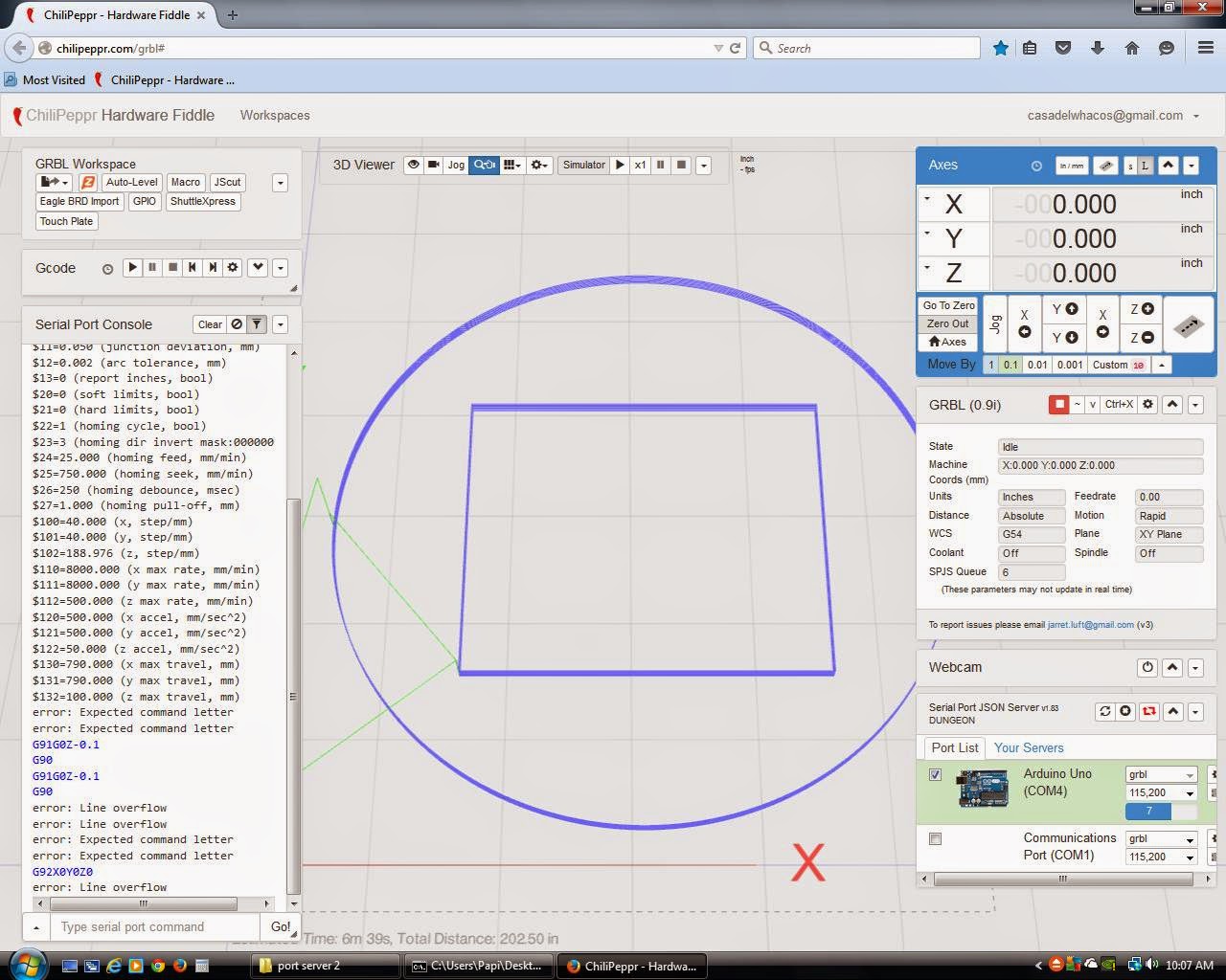

Well been trying to get the latest update to work on my X-Carve Grbl machine with no joy!
Everything worked fine before the latest release but after updating to the new JSON server CP seems to have a mind of it’s own. I keep getting errors like in the photos below and there seems to be quite a few others on the Inventables forum with similar problems.

Yeah, it’s as if it is treating the strings coming back from Grbl like it’s unicode even though it’s normal ASCII and thus the bytes are all shifted and creating whacky characters. I do wonder if this is due to the new serial port library we swapped to that solved the closing of port issues, but I swapped to that library in 1.82 and folks are saying 1.82 works.
