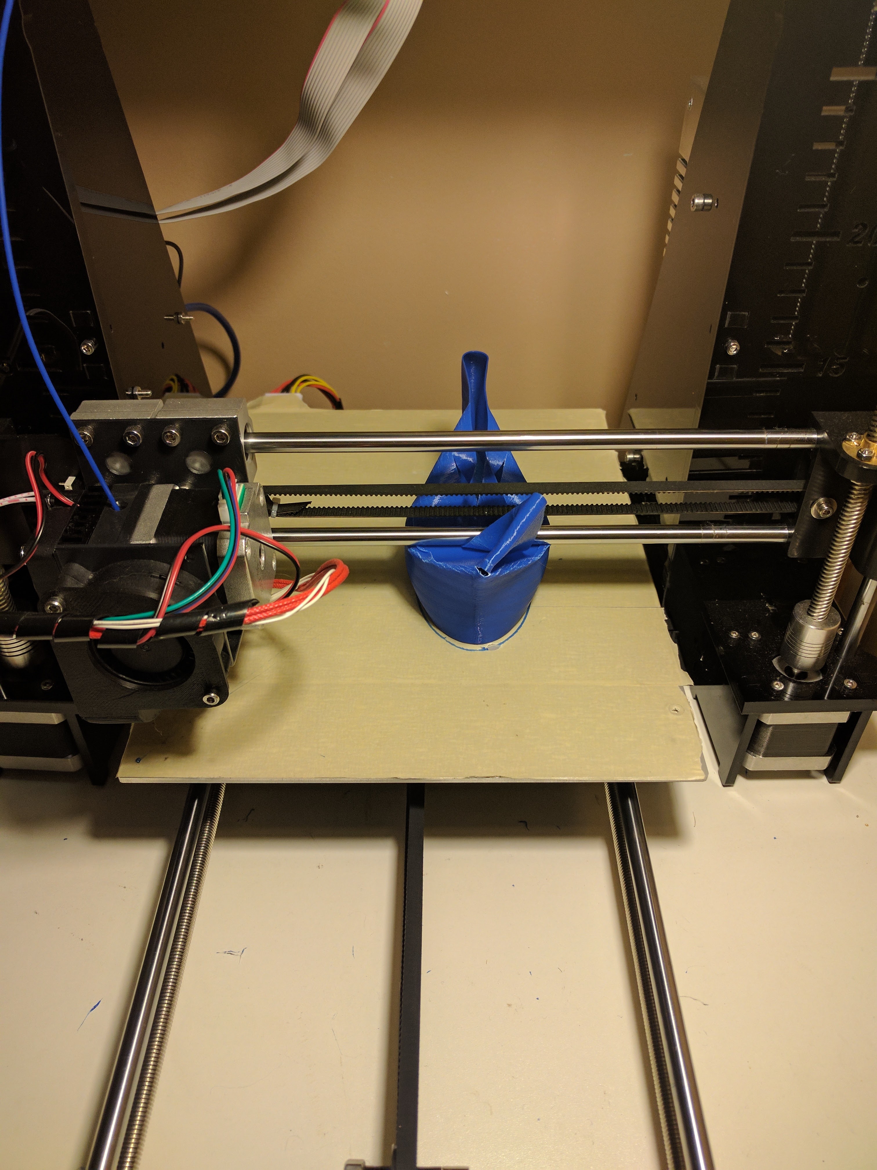

Well... Dang! What a silly post script g-code.
Well… Dang! What a silly post script g-code. It hommed Z before moving out the bed

To those that wonder why you’d home Z, some printers home to Z MAX, meaning the nozzle homes away from the print. Is why it’s a good idea to always check over any start / end codes people send you.
@Steve_M I don’t think we’re wondering why it homes Z, only why it homes Z to zero!
Home is where the limit switches are, there is a difference between moving to home and moving to Z0.
For example, if my printer homes to Z max, that means home is actually Z170, so if I gave you my end gcode that homes Z, and yours homes to zmin, your printer would home to Z0 and thus it would fail for you.
The point was more about checking your gcode than anything else though, especially if it’s gcode someone else has sent you.
I was using the end code from the reprap wiki, but the problem seems to have stemmed from having an end code from my slicer and an identical end code in octoprint… Not sure why that messed it up in such a way (there is only a small upward z movement in the end code) but when I took out the end code from octoprint it worked well
