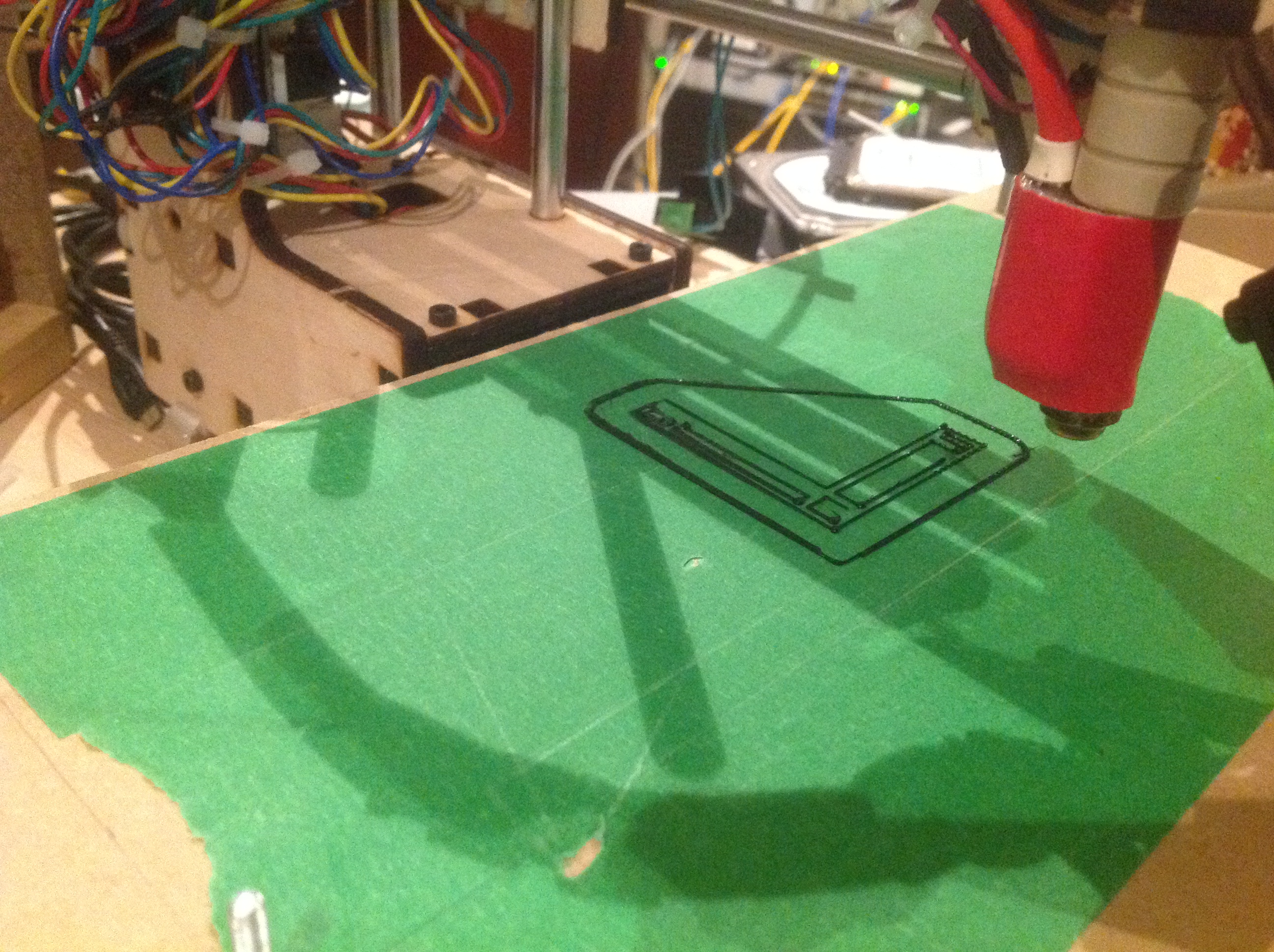

Well first test print after an auto-level is not that great...
Well first test print after an auto-level is not that great…
Think the trick to bed levelling is to have the probe almost touching the nozzle. As the further it is away the greater the error in relation to the nozzle
@Nigel_Dickinson Yeah I’ll modify my clip to bring the limit switch closer to the hot-end tip. I’ll probably remove the limit-switch lever so that only the real switch button is used.
