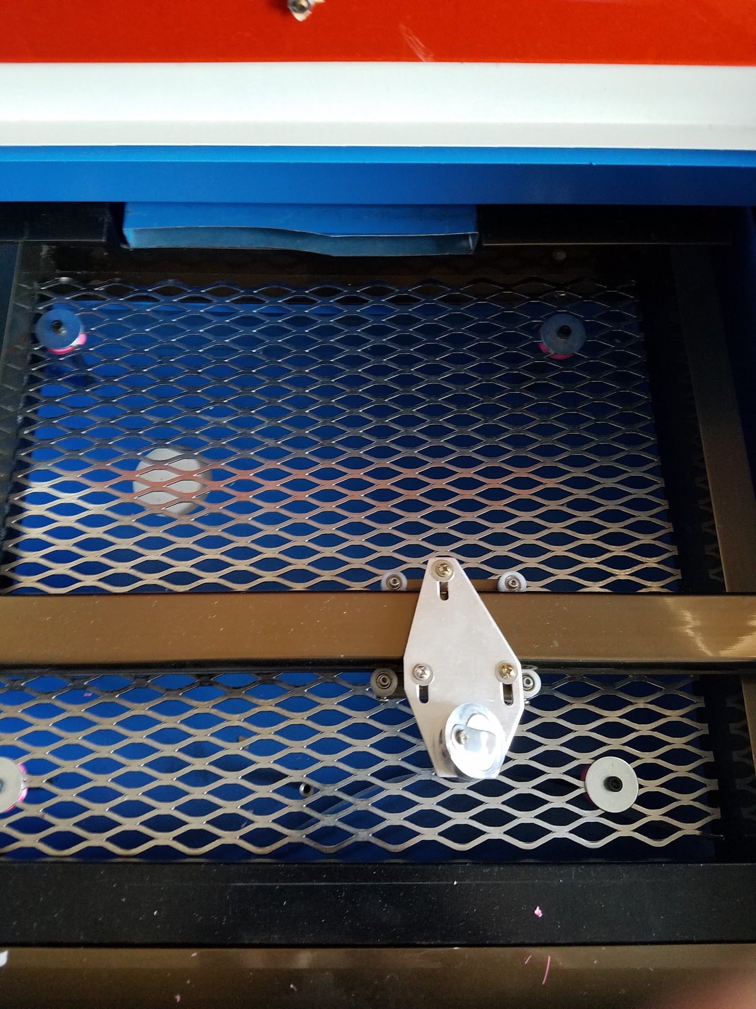

Well first to mods done, cut the air duct and swapped out the bed.
Well first to mods done, cut the air duct and swapped out the bed. Now what?

I use that same bed (from Home Depot), and I really don’t like it. When cutting, it has a tendency to heat up and burn the bottom of the piece being cut. You’ll notice scorch marks around the cutting areas, even when you dial back the power to the minimum needed to make the cut.
One way to get around this is to raise the piece off of the bed by a mm or two, but you still have to deal with reflections.

how easy is it to remove the stock bed and clamp??
5 screws hold the bed down, it was easy took about ten minutes including cutting the new bed.
What did you use to cut your duct?
I took the 4 bolts out that hold the X & Y frame pulled the duct out and cut it with a sawsall
Good idea, I cut the vent out of my analog k40 from behind as it was welded in. It works a treat.
The digital k40 I got had 4 screws holding the vent in. Given how successful the first machine was, I just removed them and ditched the entire vent.
I’ve now discovered there are massive gaps between the walls and the platform that holds the tube which causes smoke to be drawn through the laser tube cavity too.
So I’ll now need to fashion some sort of shroud to redirect things. Wish I had kept the vent and just cut it down…
