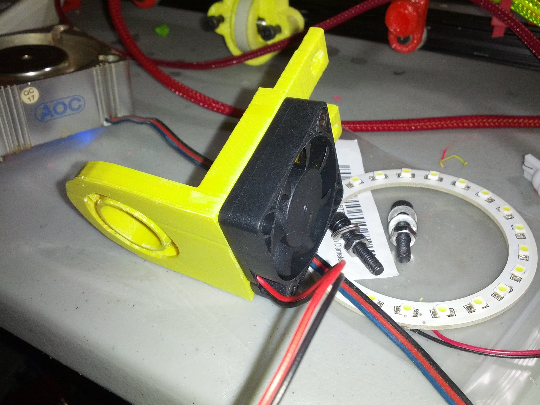

Well fsck a duct, I’m building a new duct by Addidis. He took my j-head adapter and modified it to mount a Budaschnozzle duct! Good stuff
Unfortunately I totally underestimates how big that light hulahoop was. BAh.
LOL, It’ll be fiiiine with some carpet tape. (I hate that stuff! It sticks like stink on a skunk)
Will a duct like that even flow? I’ve not been able to get any air flow out of ducts because the backpressure is so high that those little fans just can’t push any air.

There is airflow, it’s not a crazy amount though and you can tell there a lot of back pressure. Though in my experience crazy amounts would cool the extruder too much. I think it will move enough air for it’s purpose.

Yeah the thinking was too much air would have a worse effect than too little. I learned something while trying to center mine and failing, right as it melts, the air it blows gets considerably warmer. You would think this would have ruined my day but the results were rather exceptional. Blowing hot air at it is WAY better than cool air. I’ve decided to see about working it into a design. Thus far the problem is to get hot air you need to enclose the heat sink so you will probably need a mechanical door to vent the hot air either down to the print or away . This is because you need to run the fan 100% of the time if you enclose it. But cooling all the time, even with hot air is probably not good.

With that fan duct I saw about a 25-30% increase in successful bridging in the little bridge test piece. This was with the backed up duct , powered at 15 % (it cuts on at 30). So ultra slow fan helped bridge, hot air from me worked even better but i nearly fell over.
When it melted it was actually uncomfortably hot. I realized it melted because of hot hot it was. Id say 100F + but I didnt check. Figure you’e printing at 230C, perhaps half that, 3/4 of that. Basically preheat it with the heatsink.
