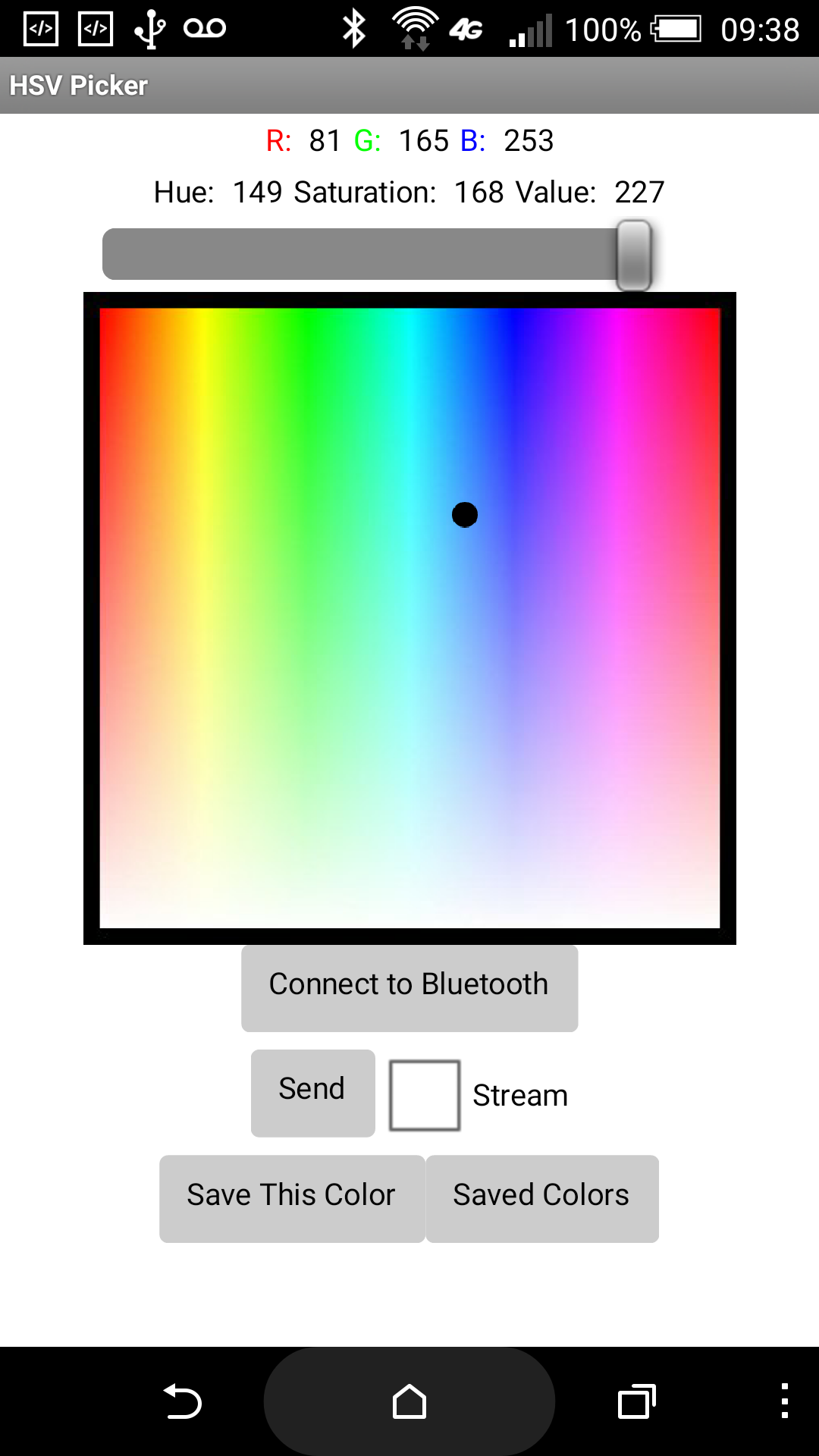

I’ve got a standalone, fixed installation that I’d like to have control over so I decided to make an app to control fastLED/Arduino via Bluetooth serial (Arduino+ HC05)
I’ve gotten most of the HSV sender page done and I’ll be adding string support for sending user configurable modes once I decide on a protocol.
The RGB values are functional, albeit strange. It pulls the color information from the pixel itself rather than the HSV function which is computed mathematically.
I will be sharing the app via GP when all is said and done and I’d love to hear if there’s anything that a fastLED user would be interested in seeing.
