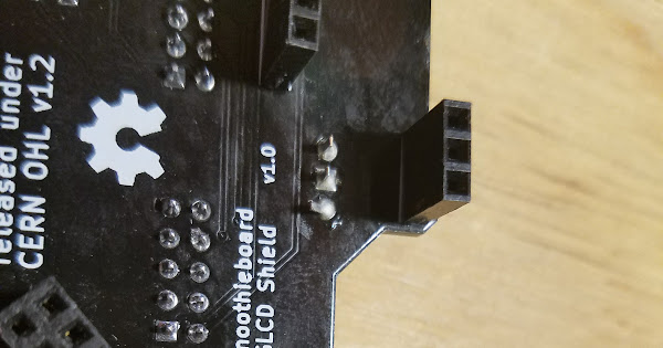

So I no more than got off this post and it dawned on me that perhaps it was a problem with the display hanging up the processor. I unplugged the display and found a bent pin.
That led me to find a melted connector. Must have touched my iron when I was soldering in the regulator. (see lower connector).
Google Photos

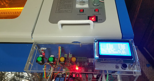

I have a happy smoothie tonight
Google Photos
