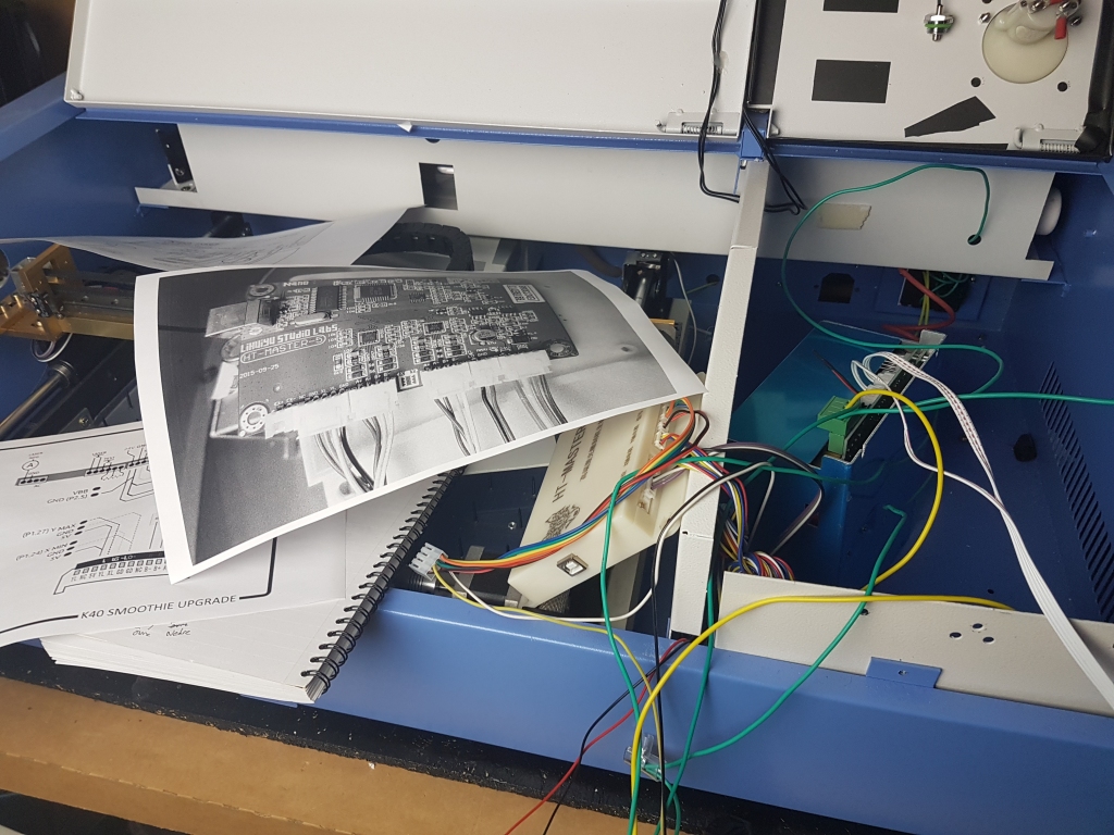

Like now… “almost” done… hah
Cohesion3D conversion.
