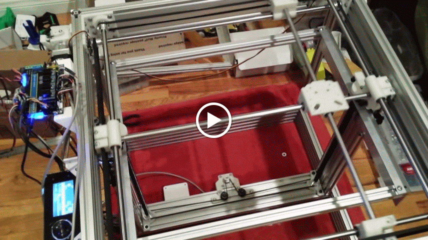

Well I got some movements, trying different speed, anything over 250mm will make a bumping sound when changing direction while the gantry is moving in a cross pattern
Looks like its happening on deceleration. Maybe some jerk setting tweaks?

Plus things look slower when they are that big, those are long traverses going on there

I have not played with the jerk setting, I copied that portion from Herculien Marlin setting.

If you are using Marlin and 1/16 microstepping, you could very well be running up against the max stepping frequency. There is a problem where if you exceed the max stepping frequency (250mm/s for my setup) there are really ugly movement artifacts. See my video: https://plus.google.com/+ØysteinKrog/posts/FPpTKnrfE27
Try to reduce microstepping, just to reduce the necessary steps that marlin has to output.
I have set my board to 1/2 stepping, which gives the correct travel distance based on the Herculien Marlin settings. I was trying to find the max speed the machine would run without loosing steps. It will safely move around at 250mm but I am sure when loaded could be a bit lower
