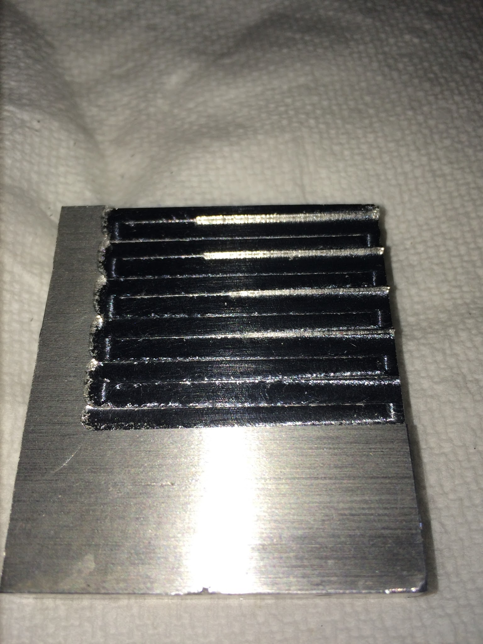

Well, I was doing great with milling aluminum until one of my hold down clamps let go. Needless to say the workpiece and the carriage went flying, but nothing is damaged save for my fingers. This poses the question: what are you using for hold down clamps, and what do you recommend? I need ideas, I’ve been having this problem since day one with my home built machine
Please excuse the poor photo, G+ is not cooperating today…

Personally i would check your tool and depth of cut. Speed your tool up and lower your feed rate and depth of cut, x, y, & z. If you have all these right you wont need such heavy clamping
It looks like you was forcing a butter knife though the aluminum.
@Aaron_Helmick the step down was one half millimeter, feedrate 50 mm/min. I certainly thought that was slow enough, especially for a 3.175 mm tungsten carbide bit… What do you recommend?
What’s your rpm?
@charlie_wallace to be honest, I can’t say for sure. My machine is uh… not good, to say the least, and it has been upgraded many times, but the spindle is unfortunately a generic, no-namer with no labels, and I don’t have a tachometer to check with. Chances are it’s lower than I think it is.
ok, does the metal coming off look like chips or dust, do the edges look like they’re melted or clean? do you know which spindle it is?
@charlie_wallace I have no idea what spindle it is, there are absolutely no markings on it. The metal coming off is chips and dust, which I assume is bad, but I’ve never seen anything except drilling make clean cuttings, so I also assumed that may not happen.
so if your RPM is too high for the feed rate you’ll basically be grinding/melting the aluminium versus cutting it, the edges won’t be clean and it’ll be dust. the bits will over heat, the metal will heat up and the tool life will shorten. you might do better with a single flute cutter if the RPM is high, like 8K+ … i run my 3.175 mm at about 30-50IPM which is 1270mm/min, but it depends on your rigidity and so on, unfortunately it’ll be some trial and error if you don’t know some of the parameters to calculate the feed and speeds. https://photos.google.com/share/AF1QipNIxid9Tkp8RtGXeBIGizXS9YTy1fMx_WhEUtTJ9NyoULI5ydIy-DDkSCJJ8pwZIg?key=aGtaUXBaTHlTQThGa09WRjkzWWdMR3N2MW82NmpR compare to my chip size. and look at the nearest hole in this video, and you can see an extreme example of it melting/grinding instead of cutting. https://photos.google.com/share/AF1QipNI_dQuNPY_mq9iaN-t-J0ECkGgmSACz4l7GUx3RKV8gssq5ZSiri0NF9FR7MHVSw?key=VDFGemh5b2FxRGNHS3J5bVFqYkJYeFhUelFqaUVR the raised edges are melty looking vs a burr. a little coolant/cutting fluid like a9 won’t hurt either.
@charlie_wallace thank you so much! I probably run much higher than 8K RPM, and I have a 4 flute cutter. I see what you mean about melting, but that’s not a problem - your cutter could probably cut my spindle in half without breaking a sweat. I’m using “tap magic” for my cutting fluid, but I’ll check out a9 as well!
@Andy_Meyer yeah probably too slow of a cut http://zero-divide.net/?page=fswizard punch the numbers in here see what you get for speeds.
