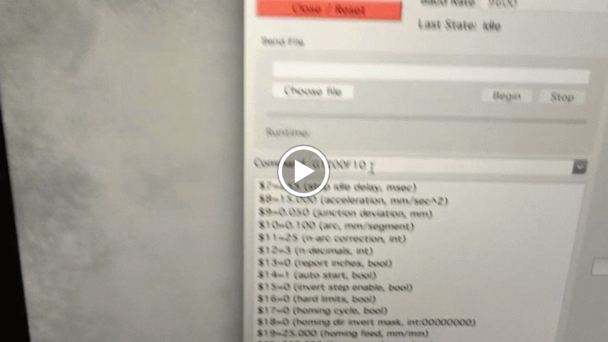

@Bruce_Lunde HI BRUCE! The motor reacts to the commands, but it won’t spin, I’m trying to rule out a bad wiring, if this doesn’t work, for sure a bad motor… what’s weird is that I tested all the motors before installing and they all worked :frowning:

@javierymirna That really does sound like crossed wires then. I would do the multimeter test…It seems like it hums when you issue commands in the video, so it is just not able to move due to crossed connections?
