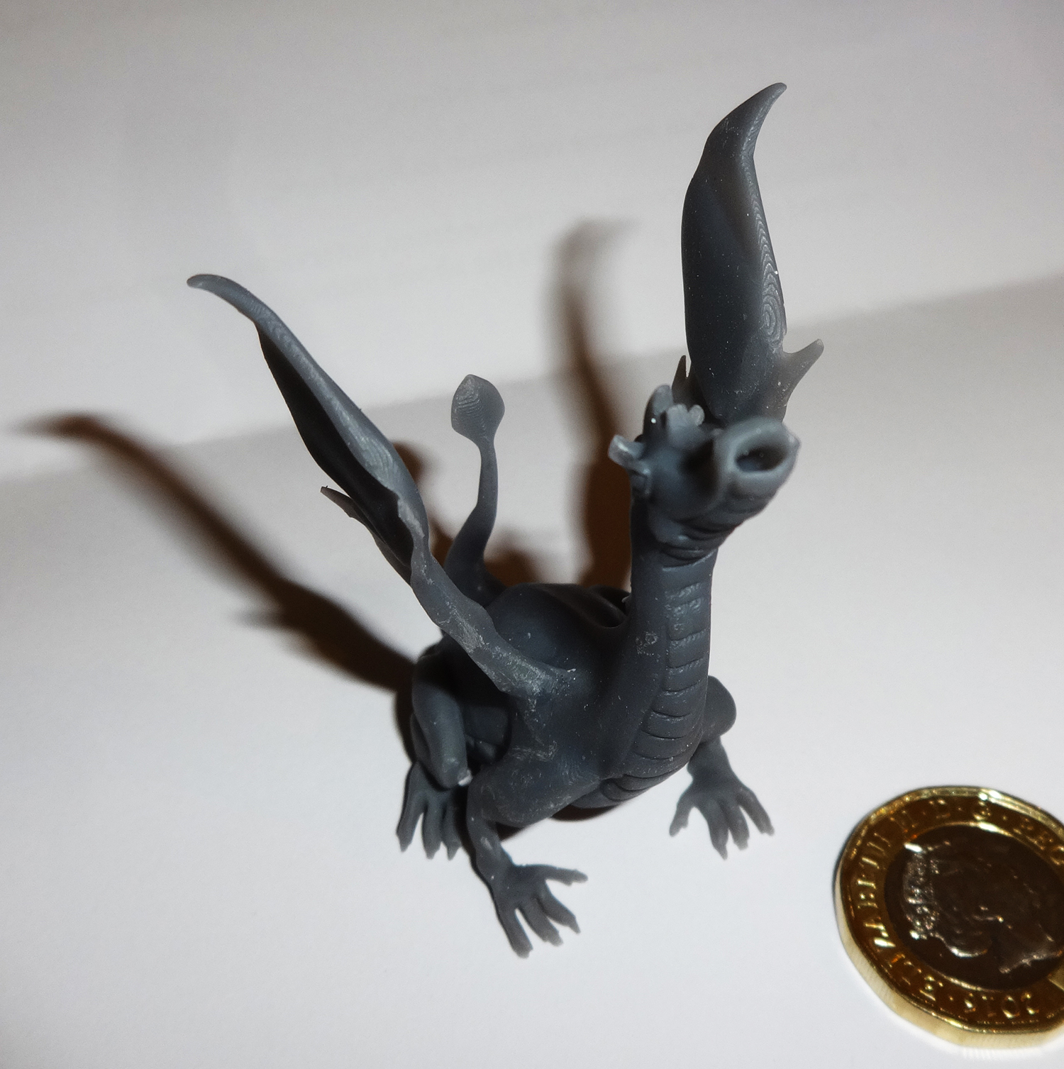

My Form 2 arrived yesterday and the first print off the bed was this - the Adalina Dragon. This is just 70mm high (the coin is a UK pound), so this thing is tiny and the detail is simply incredible. Parts of the wings are paper thin, the horns razor sharp, the tail is beautifully detailed with scales, even though it’s only 2mm or so wide, and you can clearly see the toenails on the claws and, of course, the whole thing is completely smooth.
OK, FDM is still useful for certain applications, but I’m honestly shocked at how good this print is and it’s going to be very difficult to look at my FDM machines in the same light from now on.
That is insane detail, approximately how long did it take to print?
Because of Formlabs cool online dashboard, I can tell you exactly how long it took - 3 hrs 37 minutes. Not that I think it would have made much difference, but it’s worth noting that this was actually at its highest layer height - 100 microns.

I’m curious, are items generated this way stronger, the same strength, weaker than their equivalent in ABS, PLA at some fixed infill? Can one say something printed here that is intended to be put to work is the equivalent of the same part printed with xx% infill in ABS? That would help me quantify the investment potential for me.

@Samer_Najia even the toughest photopolymer resin is not as tough as PLA with respect to tensile strength. However, photopolymer resins can have much better temperature resistance

@Jeff_DeMaagd since my Form 2 is only for customer orders, the consumable costs are passed on, so there’s no problem them. Although I’ve not done much printing yet, as far as clean up goes I’ve found it no worse than removing complex supports from FDM - better in fact, since it’s a much easier process.
