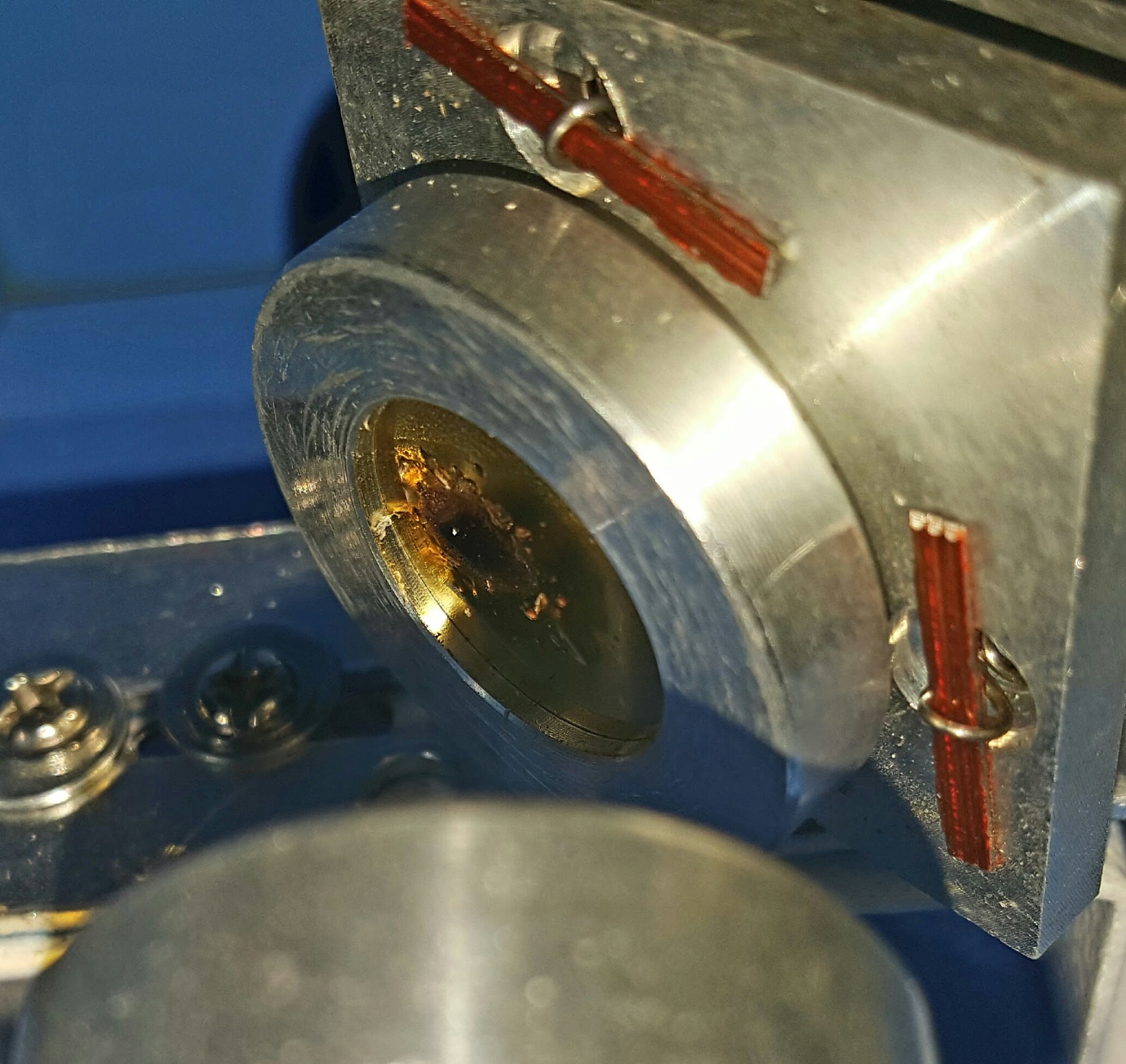

Well I’m trying to Aling the mirrors after the tube swap and just noticed this. Is this common on the lens? Seems like the costing is burned?
Mirrors do wear out ,thet need checking weekly and cleaning if needed.
When they get dirty heat builds up and damages the mirror,that is why i keep sparesnmorrors and focal les,what are u using laser for?
The laser is “brand new”. Came with a cracked tube, just being replaces
Is on the first fixed mirrror
Did you use the double sided tape to help align the mirrors? I had some residue on my mirror after using the double sided tape to align
