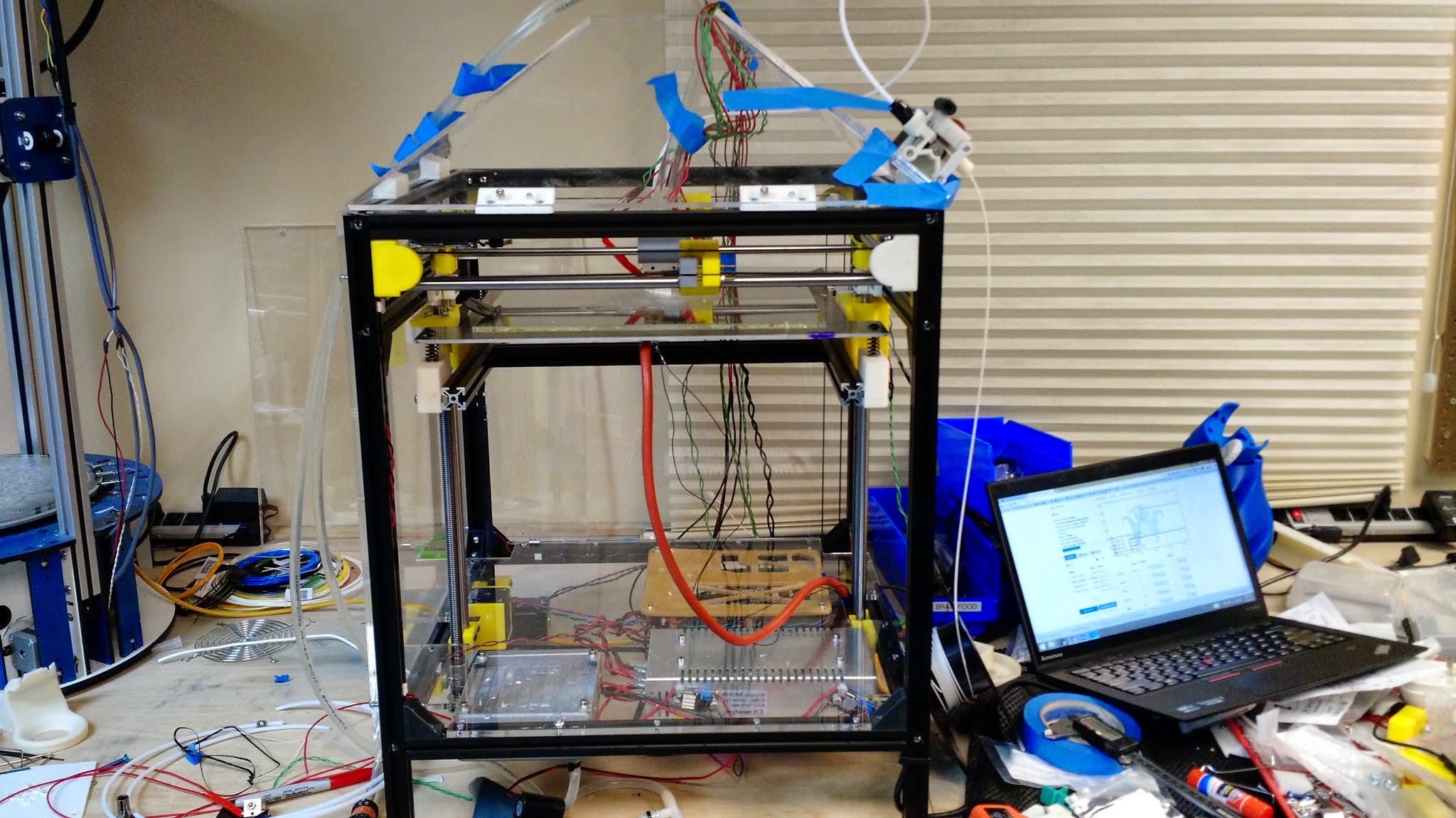

Well it is finally printing! Only one nozzle of the kraken, and I’m not buttoning up all the top and sides until it is running smooth and calibrated, but wow -
After tramming and doing e-steps, first 3 test prints have come out amazingly. I’ve never had prints look this good from the get-go - great machine! I’ll post files on pyramid top soon

@Anthony_White what thickness is the acrylic platform you have down in the bottom?
I used 1/4" for everything - top, sides, and bottom.
@Anthony_White Thanks. Do you happen to know where I can source the aluminum heat spreader and have it cut locally? Which thickness did you go with and which heater did you use? I noticed you’re in LA. I’m in the OC area.
I ordered the heat spreader cut from a local shop, wasn’t cheap. Maybe someone in the cnc google+ groups can help you there. I used 24Vheater from Aliexpress
