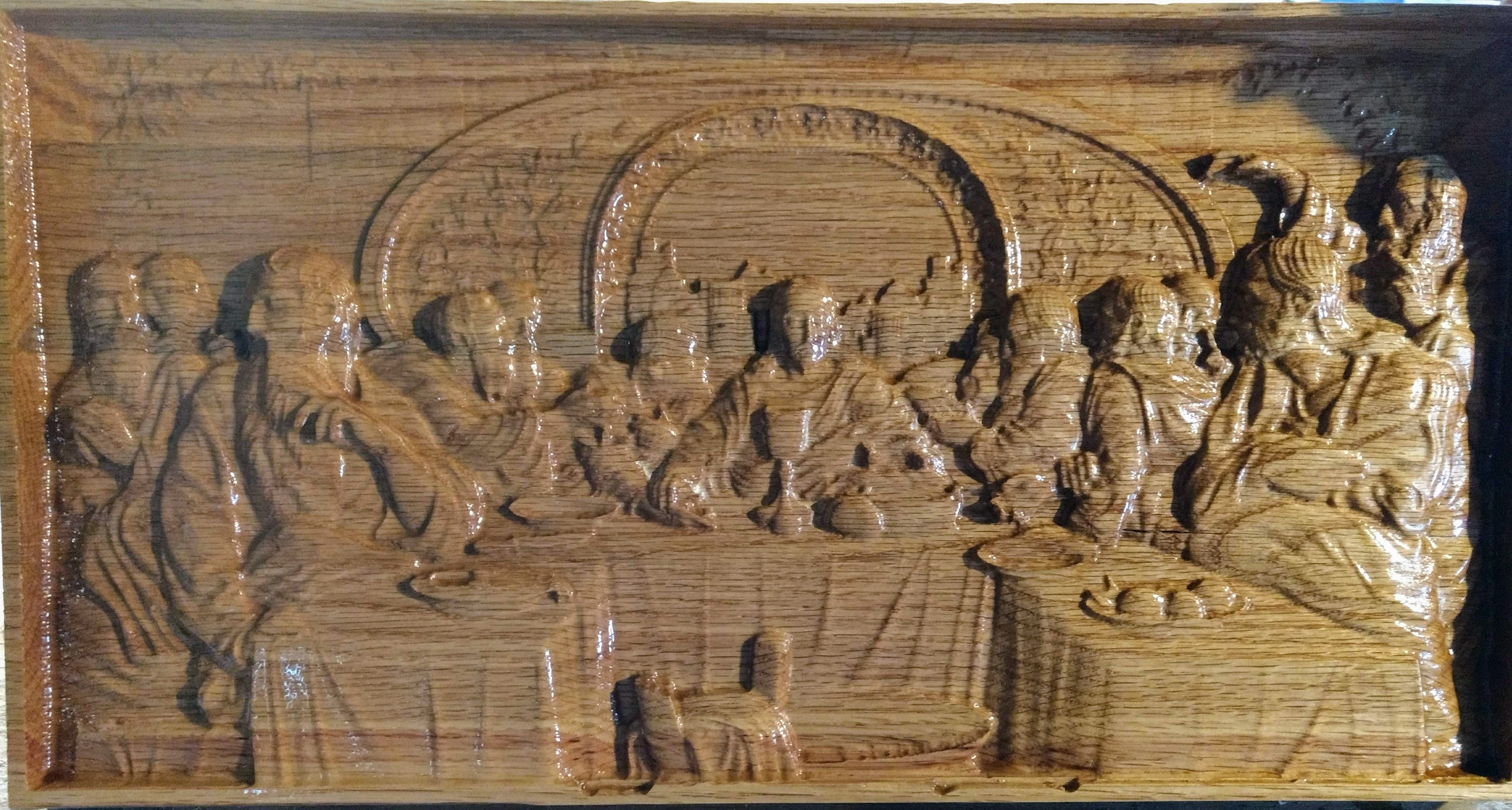

With that said here are a couple of pics of my latest works. One redone, larger scale “The Last Supper” 10x19ish, and “Grandpa” 10.5x ? I forget now, lol. Happy carving all!
