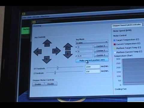

Well, it’s me again. I’m not really sure what my issue is here. I tried printing another twisted gear vase, same as I did last night. It was the exact same GCode, so not sure why it’s doing so badly tonight. And yes, I calibrated the E setting.
http://www.youtube.com/watch?v=bJwtRtPXPHE
