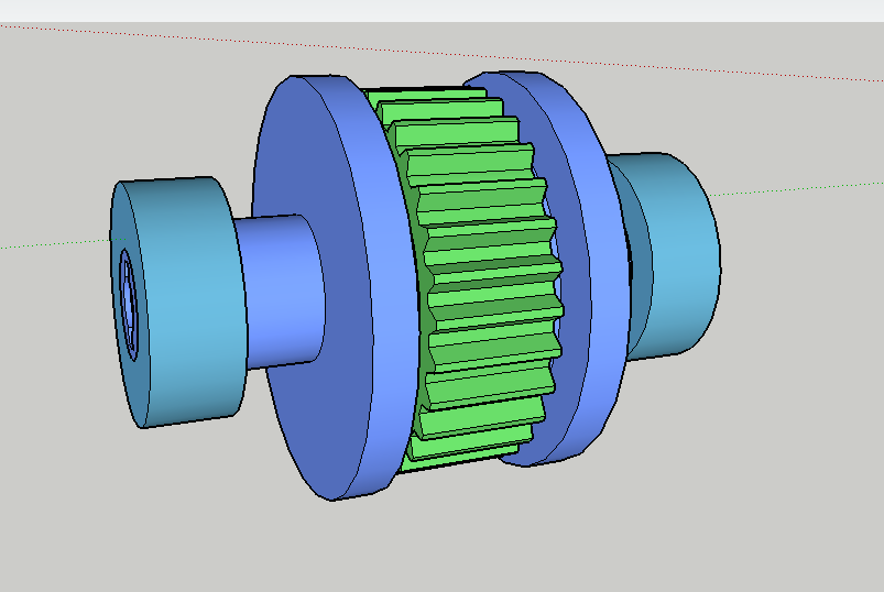

Hes what I’ve got to show you guys, this is the V3 build to my custom 1/18th touring car.
The diff gear is 30T which is very comparable to whats currently out there (Atomic Belted 1/27th uses 27T). Took a while to get the calculations right, but the meshing is perfect with my 2MM pitch belt.
Im using brass 3mm bb’s in the ball diff, and the left and right plate will be sandwiched against the balls by the bearings. Im really hoping I can get enough pressure without having to have a screw go through the whole diff, like more traditional 1/10th scales.
