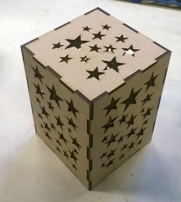

Well, I’ve been using the cutter for a week or so now. I’ve cut a load of trivial stuff like hearts and flowers for the OH’s craft projects, not quite so trivial stuff like keytags (a rectangle with a hole and some engraved text) and a few tealight holders and a couple of lasered portraits. The tealight holder is based on http://www.thingiverse.com/thing:662501/
