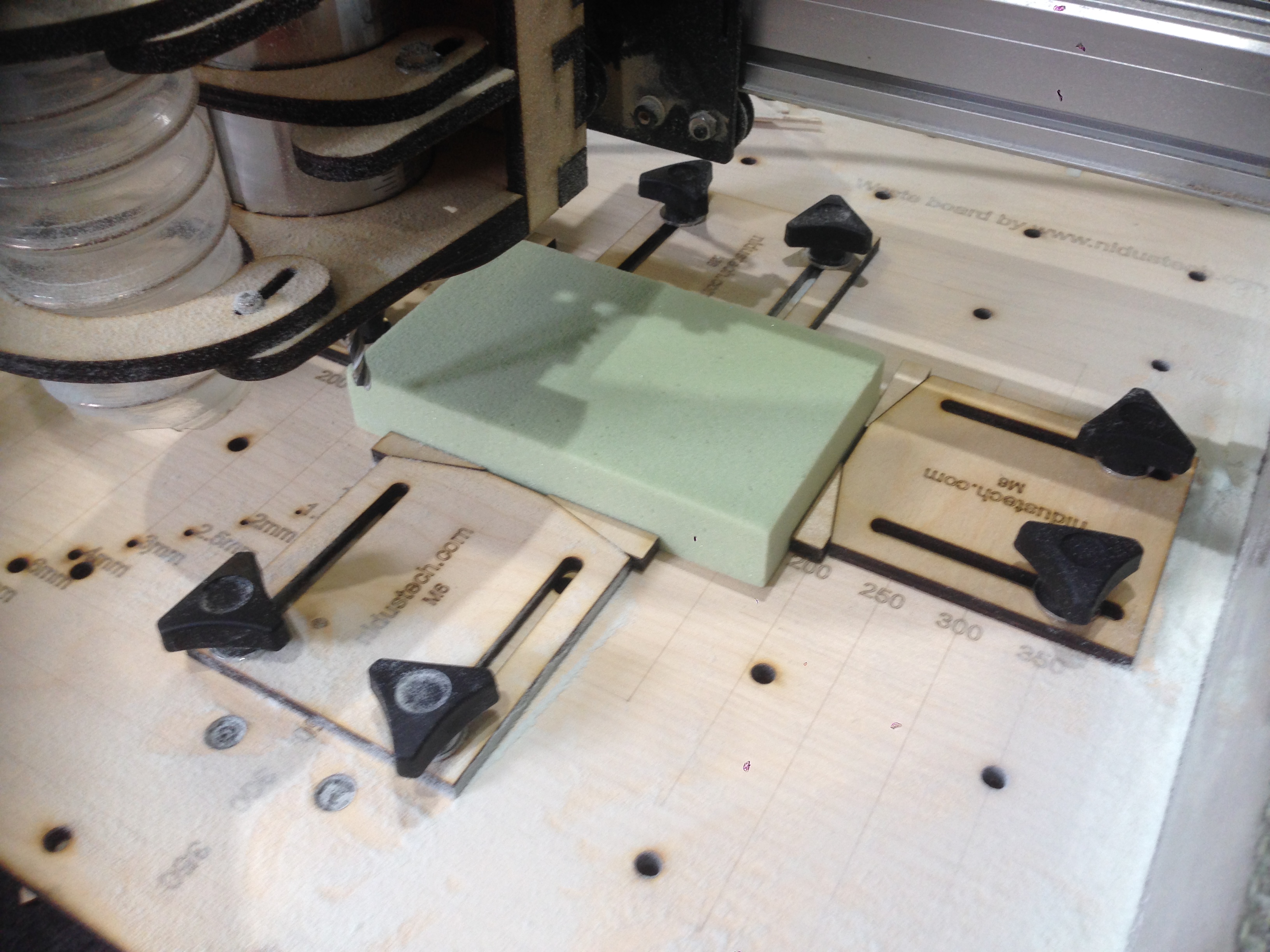

Well I’ve had fun making this and worked out how to reliably get output from V-Carve Pro to GRBL controller to Arduino GRBL 0.8c to Shapeoko 2. Phew
But there now.
In V Carve Pro use Anderston output for me in mm’s and remove 5 lines at the bottom leaving in the last Z1 and %. I will add more detail later.
This will become a climbing wall hold for the charity called ‘Urban Uprising’

Make sure you move back to the x0,y0,z0 position, do NOT unplug the stepper motor drivers, this keeps enough pressure to allow the tool to be changed without losing the correct reference point. Lift the Z – Axis up and change the tool, find the new correct Z-Axis zero point reference height using a piece of paper slide test between the tool and the chosen reference point. i.e. known block on the waste board or known height on the work in a location that is away from the final work, or if the work is tight on size in a place that will be removed during cutting to avoid any marks on the final work. You will have a new z location, record it! Make sure you move back to x0, y0, z New position.
