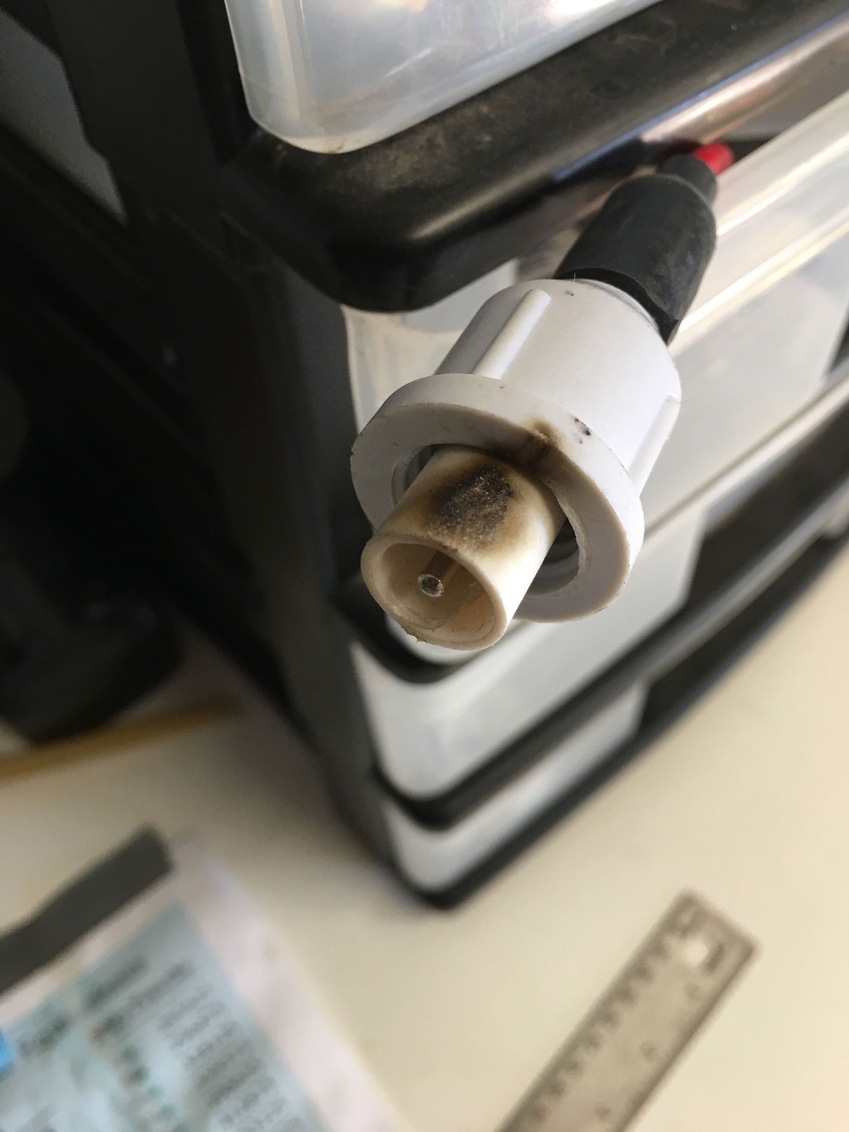

Well, just burnt another LPS. I was aligning mirrors and on my second test fire I heard a strange sound and saw a flash of light through the hole between the laser side and the LPS side. Couldn’t see anything burned until I unplugged the flyback connector and there it was. Don’t know where it arced to but I’m now on my 4th LPS. I bought an expensive LPS after the previous one blew. I guess it doesn’t matter the cost so I’m going to buy 2 of the $68.00 ones but because I have a spare, the installed one will last.
Thats rather worrying considering that is a screwed plug, where the hell could that have arched to???. I have a similar connector on mine, maybe a touch of insulation tape once it’s put together just to help it out.
Proximity matters a lot with high voltage. It seems like it must have been very close to something, perhaps the case itself? So yeah, adding some kind of electrical insulator around it would probably help prevent future arcing. Apologies if it seems like I’m stating the obvious.
Perhaps the core problem is not the supply?
When the supply is unloaded it will violently arc through/around almost anything.
Adding insulation almost never works when there is no load, I’ve tried. It can jump 2".
Will the supply still arc if you position the output a couple of inches from ground? Be careful.

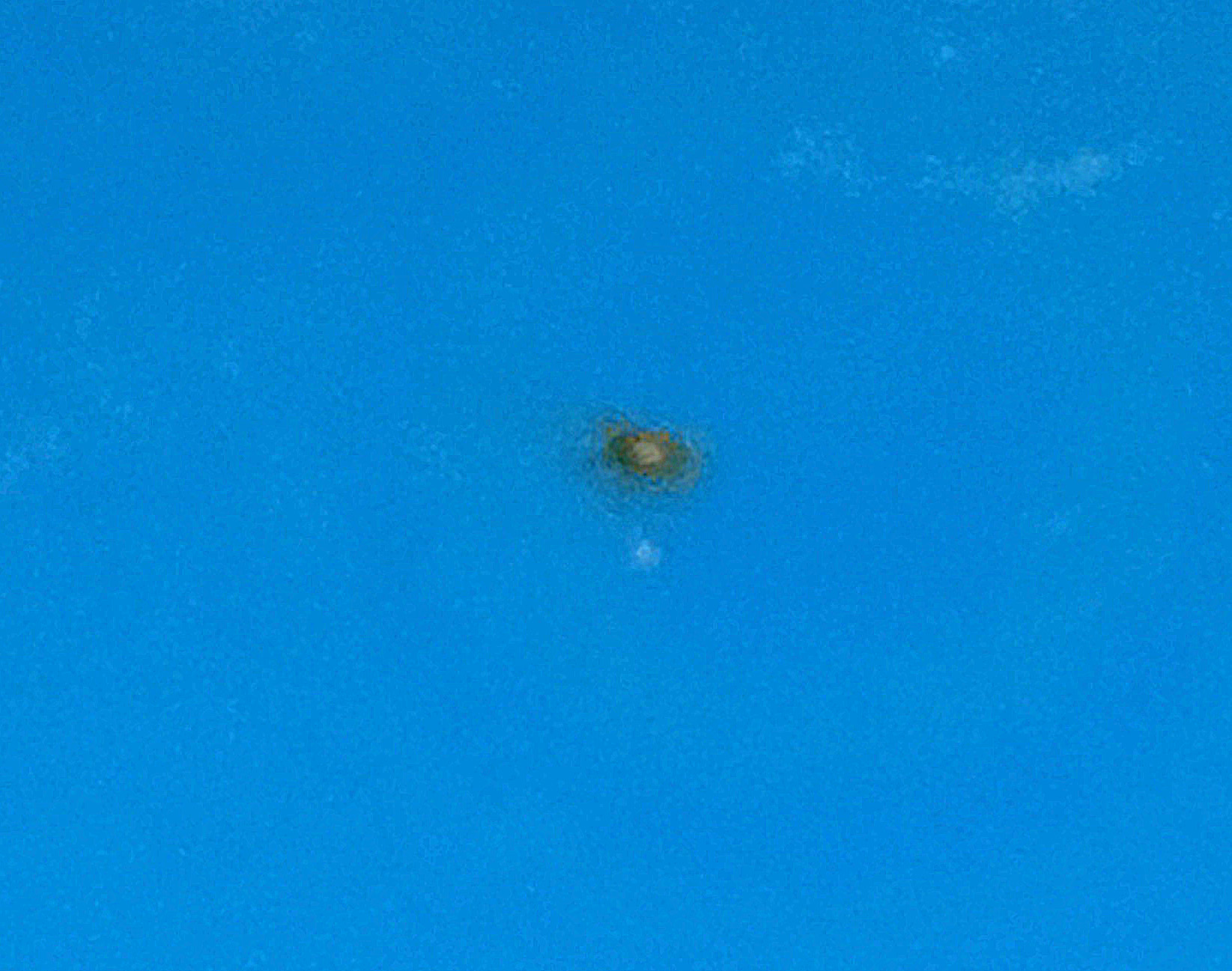

On close inspection I found this burn spot behind the LPS si it arcked to ground.
that means that path was easier than the tube itelf, one or more connections may be loose or the tube may be failing? how old is the tube itself?
Less than a year old.
